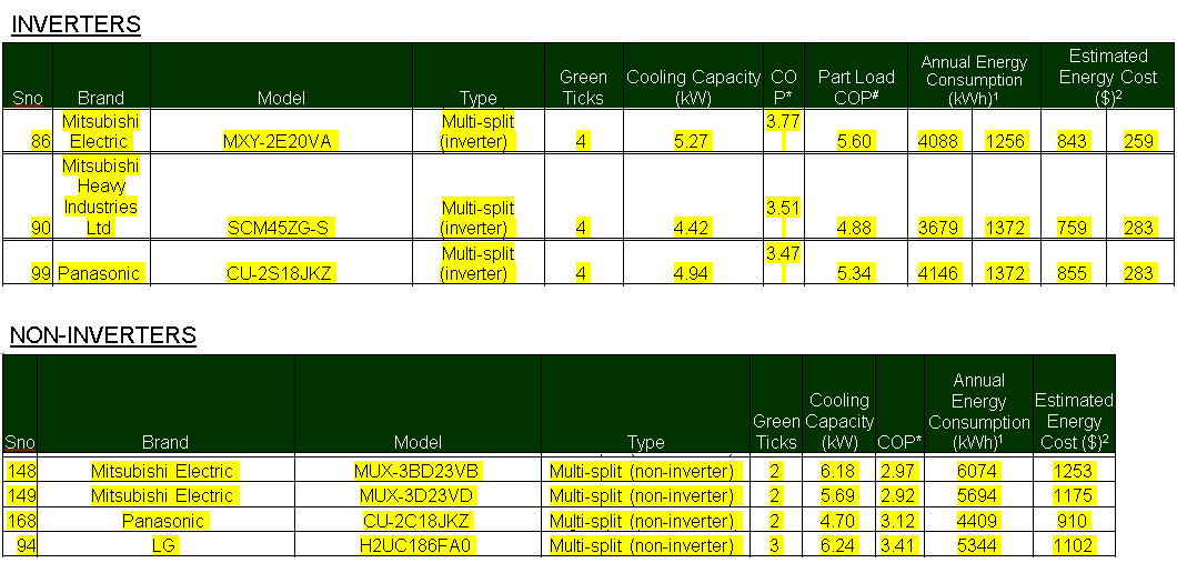

I asked Hong Tar and this is what they quote me...
Optional 1
Item Scope of Work - Inverter Amount
[1] To supply and install one set of “Mitsubishi Electric” (R410 Gas) 25,590BTU multi split $2,300.00
inverter aircon, M/N: MXY2E20 / MSXYGA10 x 2 – low stock, need to check (c/w bracket)
[2] To supply and install one set of “Mitsubishi Heavy” (R410 Gas) 25,590 BTU multi split $2,170.00
inverter aircon, M/N: SCM45 / SKM28 x 2 (c/w bracket)
[3] To supply and install one set of “Panasonic” (R410 Gas) 19,100 BTU multi split inverter aircon, $2,320.00
M/N: CU2S18JKZ / CSS9JKZW x2 (c/w bracket)
Optional 2
Item Scope of Work – Non-Inverter Amount
[1] To supply and install one set of “Mitsubishi Electric” (R410 Gas) 18,254BTU multi split $1,900.00
non-inverter aircon, M/N: MUX3BD23 / MSB10 x 2 – no stock, need to check (c/w bracket)
[2] To supply and install one set of “Mitsubishi Electric” (R22 Gas) 16,378BTU multi split $1,770.00
non-inverter aircon, M/N: MUX3D23 / MSA10 x 2 – lno stock, need to check (c/w bracket)
[3] To supply and install one set of “Panasonic” (R22 Gas) 18,000 BTU multi split non-inverter $1,750.00
aircon,M/N: CU2C18JKZ / CSC9JKZw x2 (c/w bracket)
[4] To supply and install one set of “LG” (R22 Gas) 18,000 BTU multi split non-inverter $1,570.00
aircon,M/N: H2UC186 / HMNC096D x2 (c/w bracket)
To supply and install the air-conditioners in surface mount with standard one roll of G23 copper pipe, 1/2” thick Class “O” thermaflex insulation for indoor unit and Class “1” black rubber insulation for outdoor unit, 16mm pvc pipe, pvc trunking, stainless steel bracket and cable.
alrite, doing some simple cut n paste..
lets look at the Inverters,
-among the 3, ME seems to be the higher cooling capacity, COP, part load COP. (higher COP r better)
-but than if u c the total BTU of ME n MHI, they r the same.
-MHI hav lower energy consumption and energy cost.
-take note at the part load, ME is more lower consumption n energy cost than MHI.
so in this case, ME is better becos of the higher COP stated, n the time taken to cool the room wil be shorter, thus full load wil be shorter too, becos of higher cooling capacity(BTU) also.
look at non-inverters,
-from the Green Ticks stated, obviously LG is the winner.
LASTLY, it depends on your own decision, functions of different brands, model.
some important things to note also is tat, to hav either FAN mode, or it wil auto turn on fan for sometime after u press "off" on the remote control. this is to prevent bacteria, mould, bad smell from occurring..

woah... thank you!!! the info is very useful... appreciate your assistance... =D
But the fact that now there isnt "free" extended warranty for the inverters... i'm worried...
and the sound... i mean noise... how can i check if the aircon makes alot of noisE?
u mean the sound level? u can check it out at coolserve.com.sg. than look for the model lor. it is stated under sound level, XXdB..
but i tink u no need to worry abt the noise created. its very soft..
chunlianghere is offline
So should we select based on higher COP or Lower Power Consumption? eg. ME has higher COP but MHI has lower power Consumption? (how come these two value are not consistent? i.e Higher COP should have lower power consumption?)
to wat i tink, its better to go for higher COP.
becos as u c, sometimes we turn on aircon rite, we wan it to cool the room faster, as well as efficiency. but since after it reach it temperature, it wil be on part load for the rest of the nite, thus ME is lower than MHI on part load which is gd.
sometimes got to also depends on system-X u wan. Example: if wan get system 2, each fcu can only take 9000BTU. but the total compressor BTU is 25590. so no point getting tat xtra more BTU but nv use tat much, n also payin more for it.
so hav to look out for many factors also.
but than(TO Chunman) there is a mistake, MHI SCM45 on coolserve.com.sg stated BTU is 14139. Chunman, can u double check?
