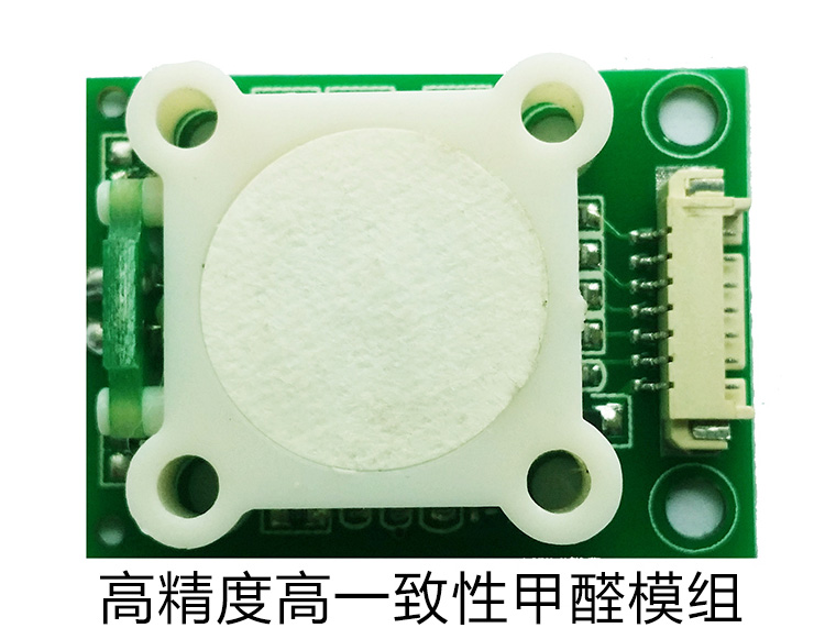

The formaldehyde and TVOC meter is actually a VOC sensor type meter and uses a simple conversion to get and display formaldehyde.
You can open up the meter to see. Uses this cheap RMB 8 sensor.
It's the left hand side one. You can put it near a can of beer (5% alcohol). It will shoot up. Or you drink a can of beer in your enclosed room and then watch it shoot up fast.
It is probably sensitive but not accurate. If you want an accurate meter, get the DART sensor that is from UK.
Lastly, the CO2, VOCs, Formaldehyde etc follows ASHARE 8hrs weighted average figures. So don't worry too much about it, unless your bottom number shows a very high figure like > 2.000mg/m3

Ok, put it this way. Go drink a can of beer, then put the sensor under your armpit. (take out the outer covering, expose the sensor)
It would shoot up way past 2.000, red LED. Trust me on this.
Either that or you have those 0.5% chlorhexidine + 70% alcohol disinfection hand rub. Use some on your hand in the room and watch it shoot past crazy levels.

The thing is i tried the device in the room without the air purifier on, just air con with windows closed. Left it on for hours.
There are some air movement due to the air con.
Reading for Formaldhyde is about 0.024 to 0.054
VOC reading is about 0.03
If there's something else, it should had went up higher.
When i switch on the AP, within minutes Formaldhyde reach 0.109, eventually reach 0.183. The higher the speed, the worse it gets more quickly.
I've also tried placing the device directly at the vent of the Air purifier, iirc it's 0.8x.
Maybe where it suck air has problem, don't know.
Anyway, I initiately expected it that it should decrease the amount of toxic in the air. I thought there's some PRC video on that.
I have a money plant outside at the balcony, that area is amazing, almost 0.000
It's possible that the new machinery is outgassing a bit of VOCs. (not formaldehyde). Any new electronics too. You know, that new gadget smell. The glues in the filter as well.
Just open the windows with a gap. I mean i cannot speak for your place coz my place is quite high floor (pinnacle @ duxton) hence there is always wind there, in fact past few days with the NE monsoon surge i got high gusts that's high enough to knock over say an empty pigeon brand milk bottle.
If your place has little wind, open that gap a little more.
No need to be area with money plant. Any open non-industrial area would have very little VOCs. It's not a plant thingy.

I actually did suspected the filter, so i took it out and run the device.
Indeed the level did not shoot up as much.
So if it's the filter, will it be the Activated Carbon that cause it instead, not sure, so the RMB29 filter may answer some questions.
If it's the Hepa in anycase, then every 6 months of replacement will renew the amount of formaldehyde again.
So hopefully it's coming from the machine.
I actually went to the park with the device, there's some recording.
Googling says formaldehyde can be created from organic compound iirc.

testerjp,perhaps you are into reading into the meter readings a bit too much and trusting of the meter absolute values. I have mentioned before above and will mention it again. It is probably very sensitive, but not accurate. I'd not be worried unless it shows to be well over 1mg/m3 <--- i am talking about your meter, not ASHRAE time weighted values.
It's probably not the HEPA, but the glues in the HEPA filter etc. Same goes for your carpet, your compressed particle board, MDF boards of your speakers or some cabinets.
Also i mentioned it's a TVOC sensor. If you go into that page, Formaldehyde is a type of VOC and is a common pollutant identified in IAQ studies. There are a few tens of common VOCs in indoor air, and the list goes into the hundreds. In the office, it comes from the carpet (several years) and also laser printer. Offices AHUs have specific ACH with external air, that is how they keep IAQ to within certain standards even wtihout exotic AC mix, gas cells made from chemicals. That is why the term TVOC / Total Volatile Organic Compounds term is coined and used. In IAQ speak, there are several hundreds of VOCs involved.
VOCs in a room are nearly the same as haze. PM2.5 requires a certain CADR in the room for it to be effective and drop fast enough within that few hours that you are in the room, preferably within 20 mins cleaning time Those plant air purifiers with fans in the roots or what you see here or in the 2015 El Nino and haze thread don't work much, not 1 or 2 pieces.
It's the same as ioniser (assuming non ozone producing and way below 50bpm threshold), they do clean the air....but in a small plastic bag / tank then you can see the result. In a room , forget about it.
I'd strongly advise you to relax and take things easy. I am very particular about the air i breathe in and also the water i drink, food i eat. You seem to be waaaaayy over my threshold even.
