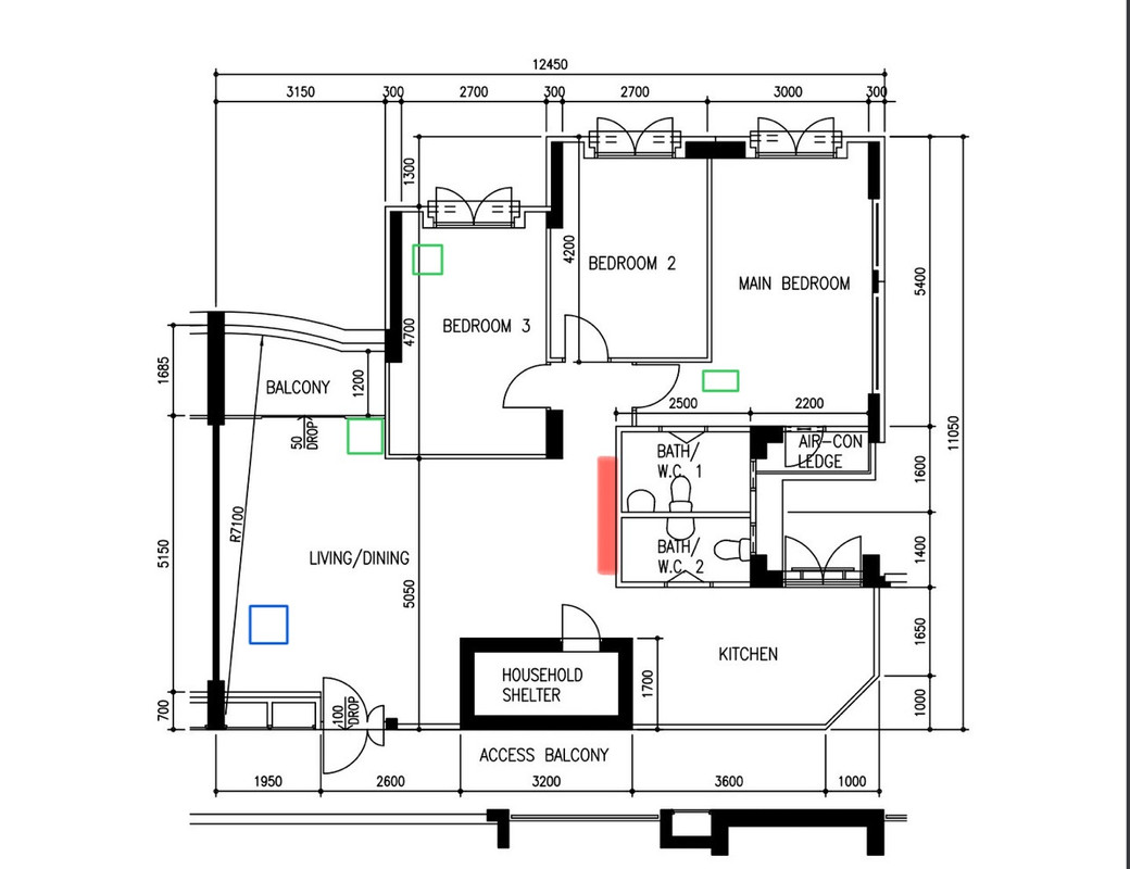

Side track a little: Not sure if anyone has any ideas….
I have a friend whose house has a huge mirror, on 3gbps plan with TP Link Deco M5x3. Previously on 1gbps, the speeds she get from her Main bedroom is around 80mbps and Bedroom 2 around 40mbps. Now, it isn’t getting any better. In the living, the speed can go up to 900mpbs on iPhone, the rest of the house dropped to below 100mbps.
Floorplan as below. Blue is the ONT. Decos were in green. Mirror is the one in red.
Are there any ways to improve the speeds around the house esp bedrooms?
TYIA!
The 3Gbps plan is bottlenecked by the Deco M5, regardless of the mirror.
The Deco accepts at best 1Gbps ethernet wired input (the WAN port). The wireless AC speed is 5 GHz: 867 Mbps (802.11ac) max.
So there is no point signing up for 3Gbps when the M5 specs do not support that.

Hello, thank you for your reply. We have also tried using the BE230 when the guy came to change the ONT, the speeds were also the same, and when it reaches the far end of Main Bedroom, the signal dropped entirely. Even with M5's capability of max 1gbps, isn't mirror the cause of the huge drop in speed? 40mbps is really low...
Would it be better to use EasyMesh to mesh up 2 units of BE230? Where should the second unit be placed to enhance the speed? Or is there any other recommendations? (There are no LAN points in any of the rooms)
Looking at the floorplan, I would suggest that you try moving the BE230 to the mirror which is right at the centre of the whole house if possible. Probably, you can try and see whether that will improve the speed in the main bedroom.
The walls are the main issue plus the capability of the BE230 router you have on hand. Especially, if you plan to use Mesh, I would suggest you get a Triband router so that you have a dedicated wireless backhaul to help mesh routers to communicate better with one another.
With the M5, suggest moving the M5 in the living room closer to the mirror and move the bedroom 3 M5 to bedroom 2 to improve the signal strength in that room. Hopefully that will not affect the speed within bedroom 3 too much.
For your initial question, wired connection should always be better than AiMesh (pure Wireless). You can setup AiMesh using TUF-BE6500 with TUF-AX3000 connected via LAN and act as an Access Point. AiMesh should help you setup everything under one SSID.
TYIA!
Previously on Singtel 1Gbps with ONR? Now on MR with TP-Link BE230 as the main router?
No LAN ports in the rooms, with big mirror?
No easy solutions then. 3Gbps plan will not help. 10Gbps plan will not help either.
1) Best solution --> to get contractor to lay cables; at least from ONT to the main Bedroom and Bedroom 3, so that the Deco M5 can use Ethernet Backhaul.
2) Throw away the mirror.
3) Get Netgear Orbi RBK853 at S$999 or Orbi RB863S at about S$1299. This may work. Both are triband AX mesh solution.
https://netgearstore.sg/products/orbi-rbk853-ax6000-tri-band-3-pack-wifi-6-mesh-system-1

Here's the floorplan:
The green area is where the ONT and routers are. The purple ones are the LAN points. Do you think adding the additional AX3000 in the Master Room would improve the speed using either wired/wiressless AiMesh?
Previously on MR 1gbps and now on MR 3gbps with TP-link BE230.
No, we removed the BE230 entirely as it is causing her work laptop to disconnect every minute. So basically, the set up is ONT > Decos, and yes, there are no LAN points in the rooms. (Initially the MR guy came and said that the M5 can still be used. So he connected ONT > BE230 > Decos)
She is not into high speed, she would probably be happy if her Main bedroom can get 200mbps. Option 1 and 2 are quite out of the question since both options require her family's approval. Option 3 is a tad too high a price..... :( Are there other viable options? @WatCult has suggested to place the Deco on the mirror side, I think I will give it a try - question though -is it better to connect Deco or BE230 in this case?
Get a new Deco then. It seems that Archer BE230 is not stable as of now based on various reports in this forum. Probably FW problem.
ONT --> Deco XE75 Pro (2.5G WAN) as main router --> wireless --> Deco XE75 Pro in Bedroom 3 and Main Bedroom
Deco XE75 Pro 3-pack at S$739 (or can try two-pack at S$429 first and reuse the Deco M5 unit in Main Bedroom)

Cheaper alternative, lower the expectation as well. 200Mbps may be difficult behind the mirror. More like 100Mbps to 150Mbps for wireless devices.
Get 4 units of the Power Line adapter and use them as "pesudo Ethernet backhaul" for the Deco M5 units. Total cost S$170.
https://www.challenger.sg/biz-solut...ort-gigabit-powerline-starter0--6935364098568
ONT --> Deco M5 --> Power Line Adapter
Power Line adapter in bedroom 3 --> Deco M5
Power Line adapter in main bedroom --> Deco M5
Power Line adapter in living room or bedroom 2--> wired device (100Mbps to 250Mbps)
Take note Deco M5 is not suitable for 3Gbps solution as it has 1G WAN port.
Thank you, so moving the living room unit to the mirror side of wall will not work in your opinion?
I believe so. You can try.
A large mirror is pretty effective in blocking WiFi signal.
Deco M5 is already a poor solution with wireless backhaul, adding a mirror in between makes the things even worse.
The issue with mirror is that it is acting as a large piece of metal that will reflect the wireless signal.
I was trying to move the main router in the living as close to the other mesh routers as close as possible in the hope that it will provide better transmission between the mesh routers even though a huge piece of metal is potentially disrupting the wireless signal in the house.
If possible, mount the main router as high as possible and see whether that will help.
Thank you @WatCult , but the socket is at a very low height area, I don't think it can be mounted too high though.. Maybe have to use an extension if this is the case.. Let me try it with the wall socket height first and see if it helps!
