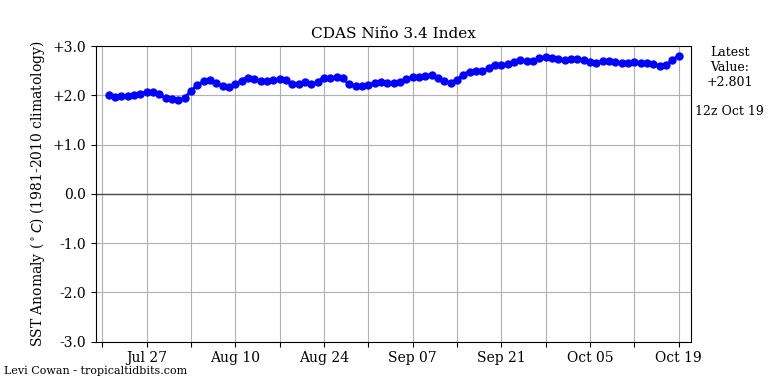

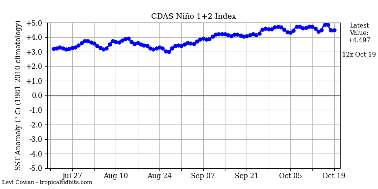

This thread would contain the latest weather information with regards to El Nino 2015, and also Indonesian Haze.
El Nino 2015 data
Nino regions
The key area to take note of is Nino 3.4, the key area in which the intensity of an El Nin is based on by scientists/weather folks. But this doesn't mean that Nino 3 isn't of interest as well, its huge size means that it also extends a great effect. Nino 1+2 is a small region, but is also gives you an idea on the SSTs off S America. In a classic El Nino during its peak and matured stage, all the warm water is piled up in the eastern pacific ocean off the coast of S America. A good portion of it may be in the central pacific as well.
SSTs / Sea Surface Temperatures
Sea surface winds (take particular note of the second diagram that shows the Anomalies)
In a normal situation, the trade winds blows from East to West at the equator in the Pacific ocean. ie easterlies. On a wind map, this means "right to left" arrows to the layman.
For an El Nino to form and sustain, we'd need the wind to blow the opposite direction, from West to East. The stronger the westerlies (wind coming from the west) blows, the more "juice" the El Nino gets because more water would flow to the East towards S America. This is a very layman explanation, the processes are deeper than this.
Just that it that we'd need a lot of these "westerlies". We can call these Westerly Wind Bursts.
El Nino 2015 data
Nino regions
