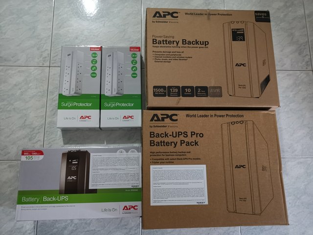

Now, I have Type 2 whole-house surge protection. I have also added Type 3 surge protection at the point of use by using APC surge-protected power strips. The higher the surge energy the better is the surge protector.
https://www.apc.com/shop/sg/en/products/APC-Performance-SurgeArrest-6-outlets-230V-UK/P-PM6-UK
Note that if you have DC devices at home like UPS, LED lightings etc then a Type A RCCB is required.
As of now there's no Type A RCCB being approved by the local authorities yet. So no electrical shop is carrying it for now.
However, if you buy online and install yourself then you take the risk of any consequences.

The higher that current number, then the lower the resulting surge voltage will be. A concept taught to first semester engineers. It is a current source. Voltage only increases when something foolishly tries to 'block' or 'absorb' a surge - such as a plug-in protector.
Higher tens of thousands of amps define a protector's life expectancy over many decades and many direct lightning strikes. Protection during each event is defined by that low impedance connection to and the quality of earth grounds. The better (lower impedance and more conductive) that connection to earth means a surge is less likely to be anywhere inside.
Let-through voltage says nothing about how well protection works. Let-through voltage only defines what service voltage can connect to that protector. For 120 volt service, that protector must be at least 330 volts. For 230 volt service, it must be something well above 500 volts. For telephone, that let-through voltage is often somewhere between 200 and 300 volts. In every case, let-through voltages defines a voltage so that normal service voltages do not destroy that protector.
Type 3 protectors are so grossly undersized as to be more than 10 meters from a main power panel and earth ground. So that is does not attempt too much protection - and therefore threaten human life. Plug-in protectors, essentially, have no earth ground. But worse, can even compromise (bypass) what is already superior protection inside electronics. Yes, sometimes make damage easier.
An IEEE brochure demonstrated this. A protector in one room earth a surge 8,000 volts destructively through a TV in the adjacent room. That protector has no low impedance (ie less than 3 meter) connection to earth ground electrodes. So it earthed that surge destructively through a best connection - that TV.
Only Type 1 and Type 2 protectors are sufficient sized to make that low impedance connection to earth.
That existing panel may not have a sufficient connection to earth. And just to be clear, every ground is different; with a different adjective preceding the word "ground". Relevant here is one specific ground - single point earth ground.
A protector is only as effective as its low impedance connection to and the quality of those earthing electrodes. Protectors are only a connection device to what does all protection. So that a surge is not anywhere inside. Then best protection, already inside all appliances, is not overwhelmed.
Devices that would suppress ('block' or 'absorb') a surge are best called scams. Are typically inferior to protection already inside appliances. But sure are profitable.

To follow up, my APC Type 3 point-of-use surge protection devices just arrived
1) 1xBR1500GI UPS
2) 1xBackUp Battery BR24BPG for the above UPS
3) 1xBR900MI UPS
4) 2xSurgeArrest PM8-UK Power Strips with 8x outlets each
They are for the protection of my electrical/electronic items.
- UPS meant for continuous power supply to router, modem, hubs, ip cameras, safety detectors etc
- SurgeArrest surge-protected power strips for AV equipment, laptop, PC, TV etc
