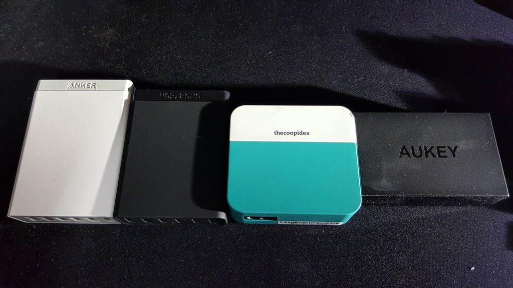

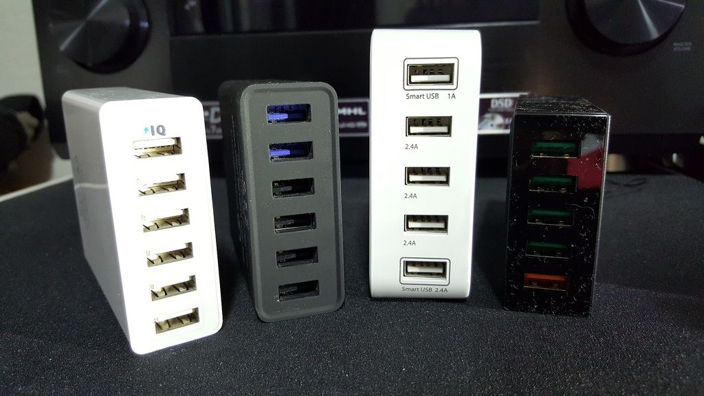

Here are the multi port chargers contender.
From the picture left to right:
1. Anker 6 Ports 60w
2. Choetech 6 Ports 60w with Qualcomm Quick Charge 2.0
3. Thecoopidea 5 Ports 55w
4. Aukey 5 Ports 53w with Qualcomm Quick Charge 2.0
More on each individual multi ports chargers
Anker 6 Ports 60w
Anker 6 Ports configuration is pretty standard supplying all ports at 2.4A max each. Using an IQ device detection, it is their terms for detecting any device connected to it and supply the fastest charging capabilities to each devices. However at 60w, this charger will have an issue if you managed to saturate all ports with 2.1A rated devices. Such as 6 iPad Minis or iPad Air etc. For example based on single port testing of 1 iPad Mini 4 took in at 2.03A @ 5.08V gives you 10.31W, if you gonna plug in all 6 ports it will only give you 60W in total. A small sum of wattage will be lost. And hence if the unit is too hot, it will throttle down the performance, and it will not charge at its full potential.
Thecoopidea
Thecoopidea is one of the best 5 Port Charger which is rated as it is. Despite the configuration is slightly different from the rest, it gives a total of 53w max output. It is still very "powerful" why? This charger has 4 Ports rated at 2.4A each out of all the 4 Ports, 1 of the Port is Smart USB charging, and lastly 1 Port 1A. Judging from just 1 Port charging the iPad Mini 4, it takes in 2.15A at 5.10V on Smart Port, and 2.05A at 5.12V on regular 2.4A Ports. This will give you an effective 10.96W + (10.49W * 3) + 5.16W = 47.60W. Leaving you a little more head room before hitting max 53w.
Choetech 6 Ports with Qualcomm Quick Charge 2.0
This charger is really under powered only if you use 2 quick charge 2.0 device to charge at the same time, and not only that, the rest of the 4 ports will not output the maximum capable output. Reason being that in theory, the 2 qc 2.0 ports max output is 36W. For some reason, the other time i tested my Aukey Powerbank which charges 1A @ 12v and Samsung S6 Edge at 1.6A at 8.89V which already hit 26.22W out of 36w that both qc 2.0 ports can handle. Note that it even throttles once in awhile when it is far too hot. And when you have 2 qc 2.0 enabled device charging, and you include a couple of 2A rated device on the remaining ports, it will be boiling hot, not only it will throttle to keep it cool, you will only have less that 9w per normal 2.4A ports. Which will effectively slow down in charging.
Aukey 5 Ports with Qualcomm Quick Charge 2.0
This charger is the smallest among the rest of the charger above. Since this comes with just 1 qc 2.0 port, the total output of this charger is 53W, since it has a maximum of 18W for 1 qc port. Leaving the rest of the 4 ports at 8.75W each, which in turns not really a powerful charger afterall. However if you are just charging mobile devices such as the S6 edge which only takes in a max of 14W, you are left with a rough 9.75W-10W region per port. Which is reasonable and also able to charge any other devices normally if you did not exceed the 14W qc port. And after testing for a few days, i did noticed that this charger is somewhat the most aesthetically inclined product against the rest of the multi ports charger. And lastly it is not as hot as the Choetech while charging. In fact it sits somewhere in between the Thecoopidea and Anker in terms of heat.

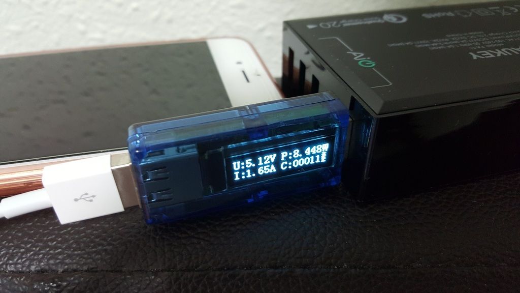

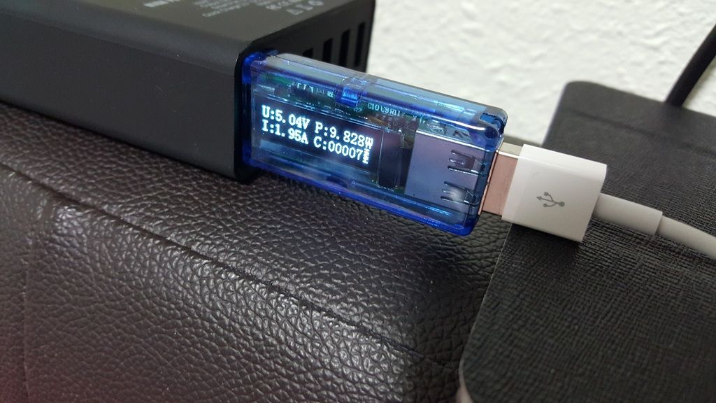

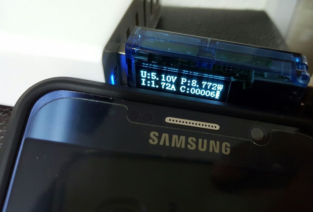

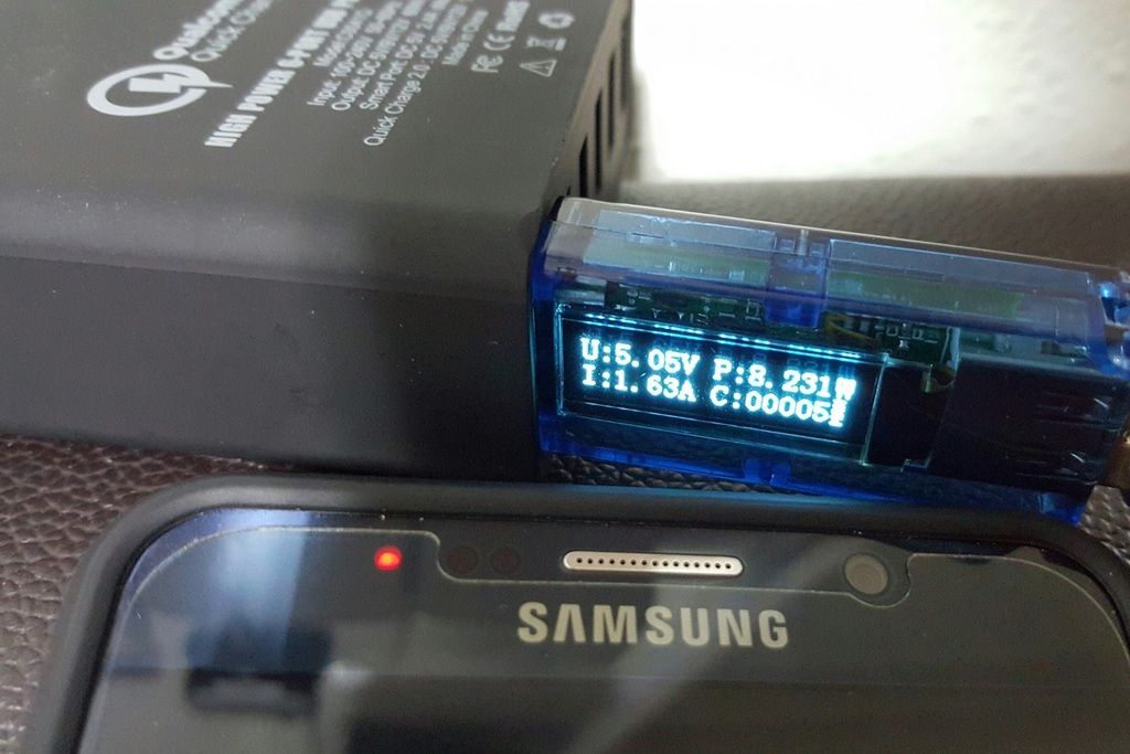

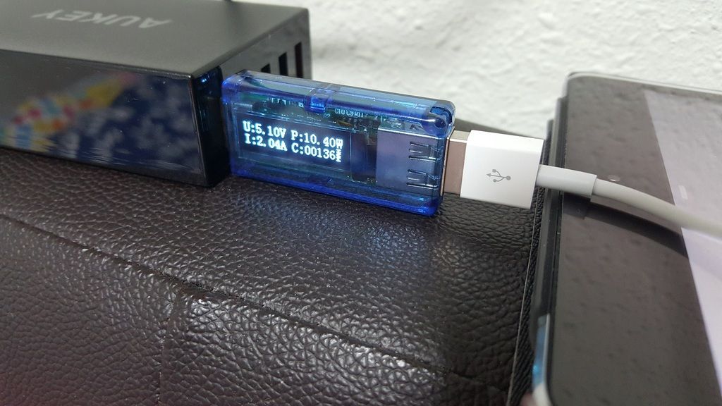

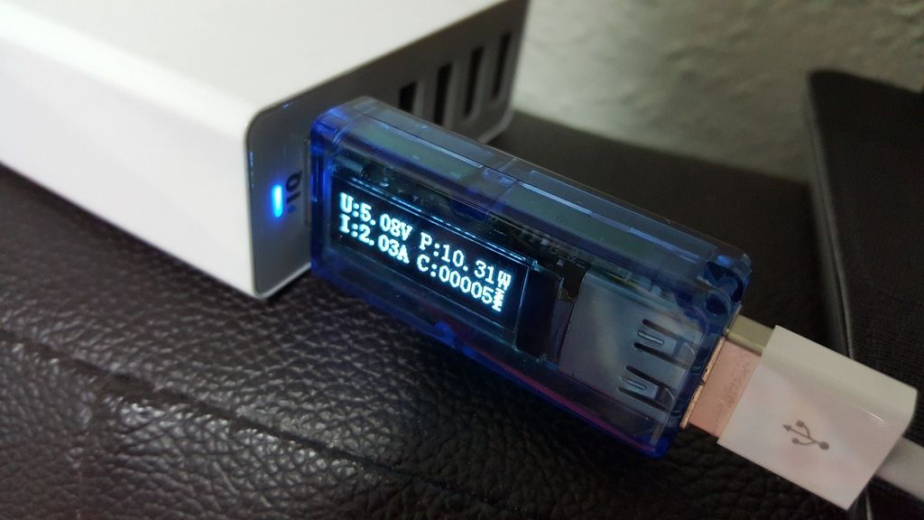

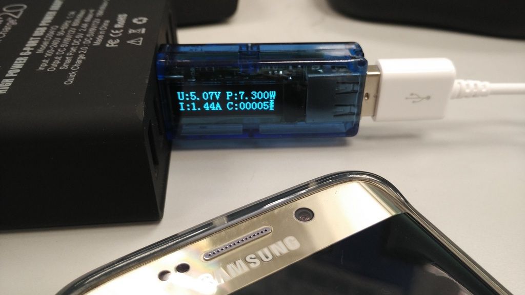

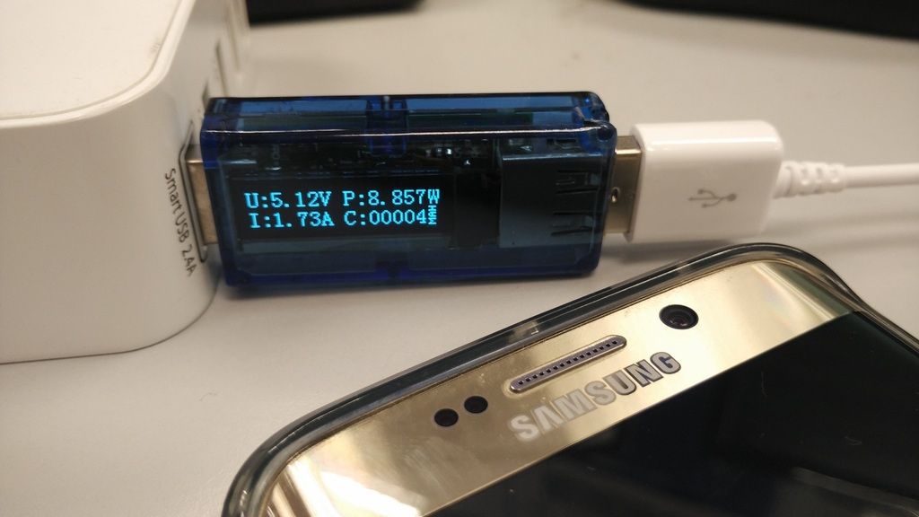

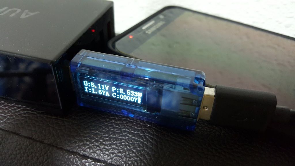

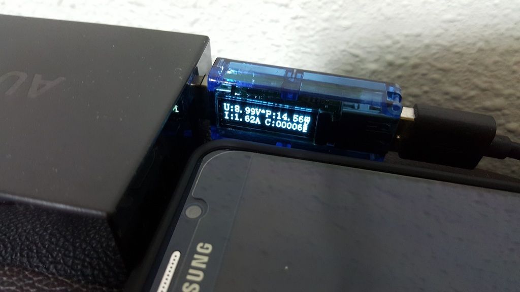

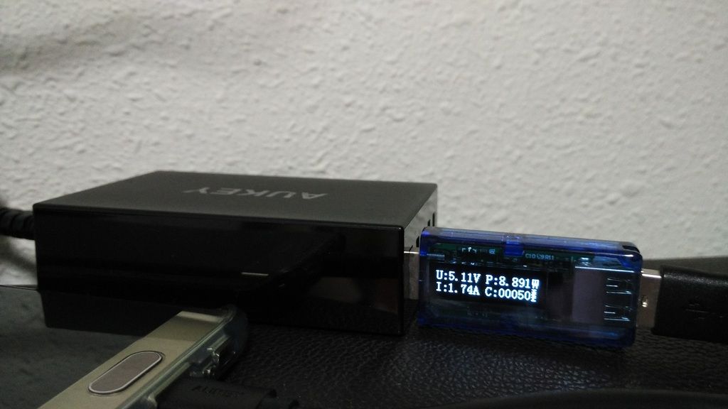

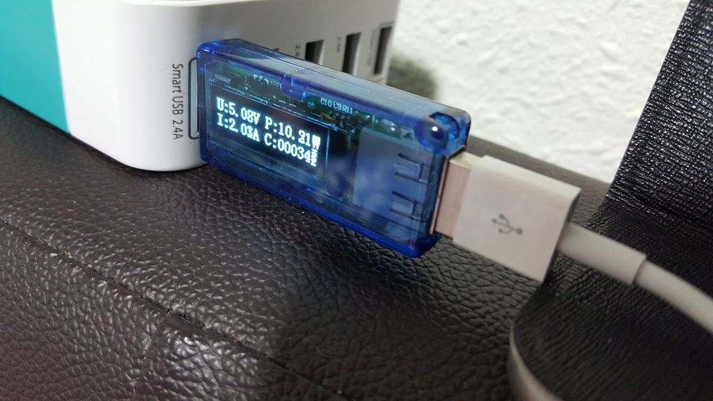

Samsung Galaxy S6 Edge
For the start, the Aukey took a lead with a total of 8.891W, followed by a tiny difference from Thecoopidea which managed to output a total of 8.857W, followed by Anker 8.364W, and the last would be Choetech at 7.3W, BUT however, since the phone has Samsung Adaptive Charging capabilities, both the Choetech QC 2.0 and the Aukey QC 2.0 will lead in fast charging. Results shown that the Aukey took the crown at 14.43W, and the runner up goes to Choetech which doesn't look shabby at 14.3W.
Anker
Thecoopidea
Choetech
Choetech QC 2.0
Aukey

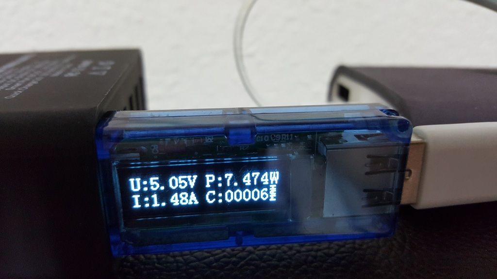

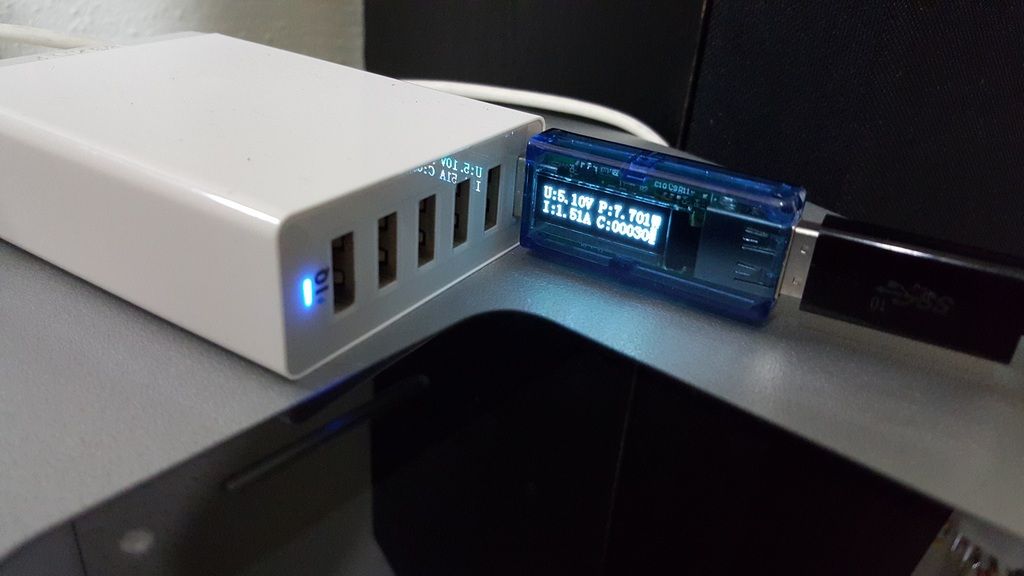

Aukey QC 2.0

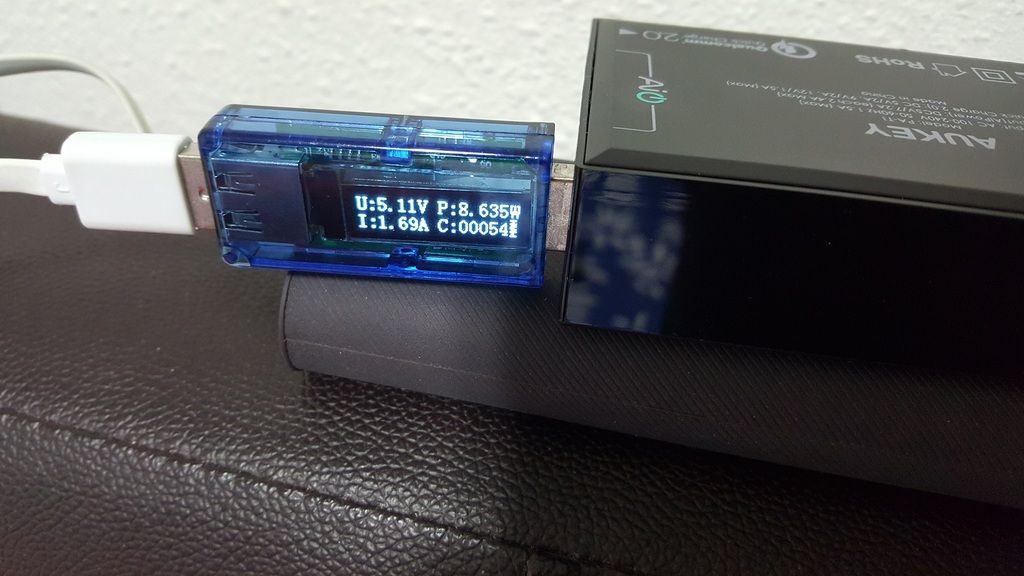

Aukey 15000mAh Powerbank with Qualcomm qc 2.0

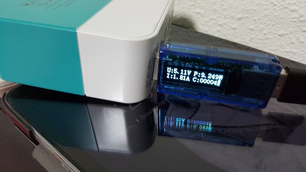

This Aukey Powerbank is one of my favorite powerbank that i have ever used. It is able to accept QC 2.0 using a QC 2.0 certified charger. Also this powerbank is able to charge any QC 2.0 enabled devices with its QC 2.0 port.
All right for its charging capabilities, Thecoopidea and Choetech are somewhat drawing about the same wattage of 10.42W and 10.41W respectively. Unfortunately Anker did slightly below than the other two charger and drawing 10.34W. Which is still good. But then again, since it is a QC 2.0 enabled powerbank, the Choetech takes the crown again with its QC 2.0 ports delivering a massive 11.82W.
Anker
Thecoopidea
Choetech
Choetech qc 2.0
Note: I have reuploaded the measurement again for this test. The last time the wattage was not tallied against the current and voltages, it was not able to show 12V. But after testing it on Aukey multi ports, the Drok was able to display 12V, so i suspected that there was some error calculation with the Choetech qc ports. So to confirm the correct reading again, i did a re-measurement again just to make sure there is no error. However it is true that the Choetech somehow did not managed to hit 12V. So here is a new score for Choetech qc and yet there was a small error reading on wattage.
Aukey
Aukey QC 2.0

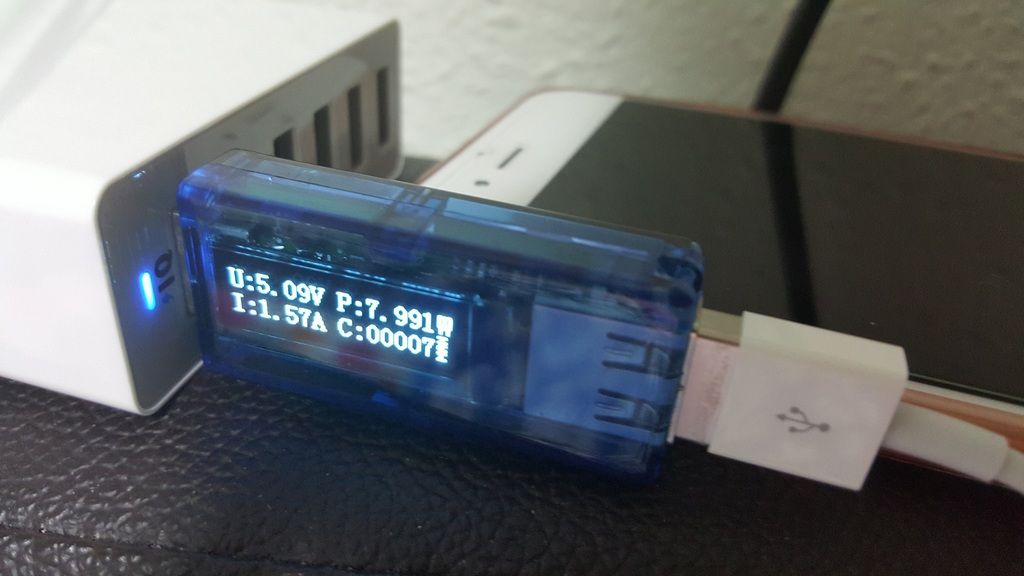

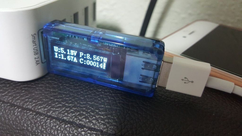

Apple iPhone 6 Plus
The iPhone 6 Plus may seems like a big phone with big power charging capabilities, but end up it isn't. Thecoopidea came in first as it deliver a solid 8.567W, Edging out the Anker, Aukey and Choetech. Aukey came in second but still a respectable 8.448W. Anker came in third with 7.991W, whereby the last will go to Choetech at 7.843W.
Anker

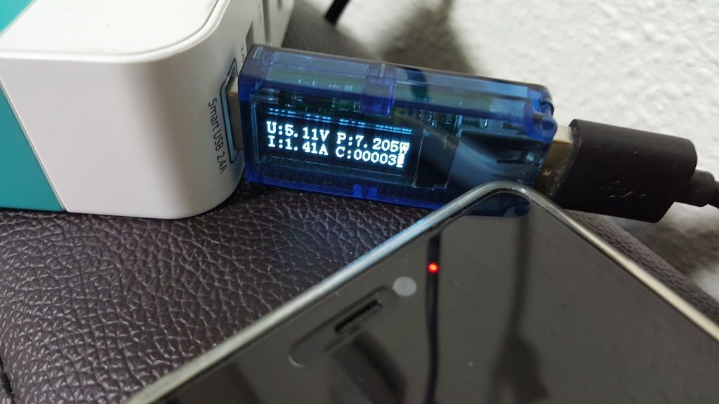

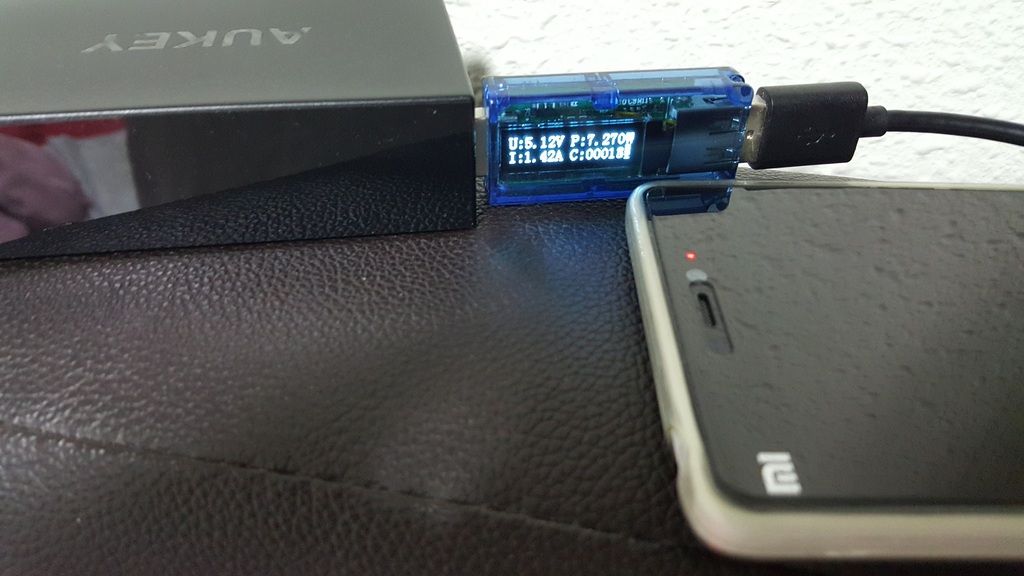

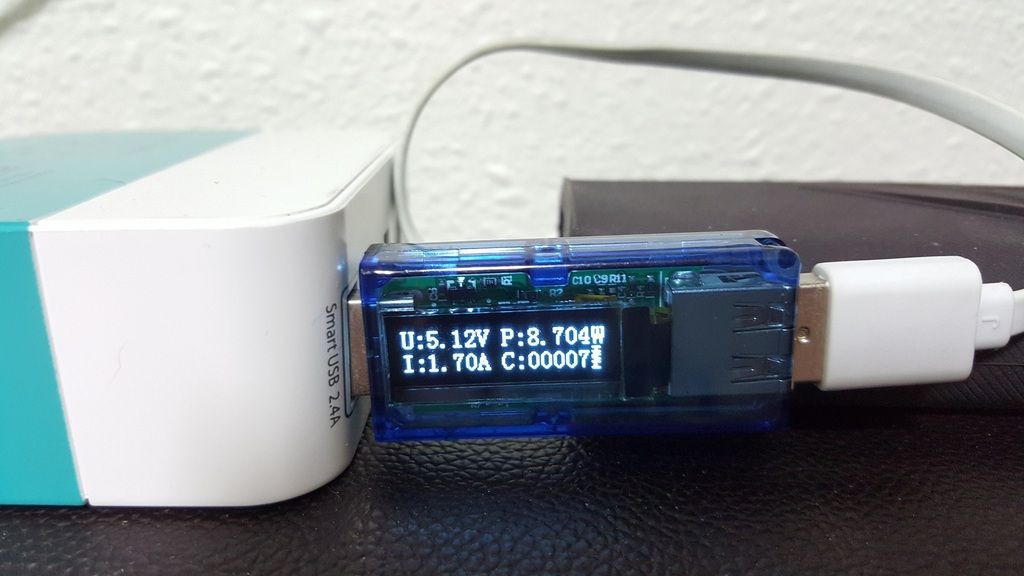

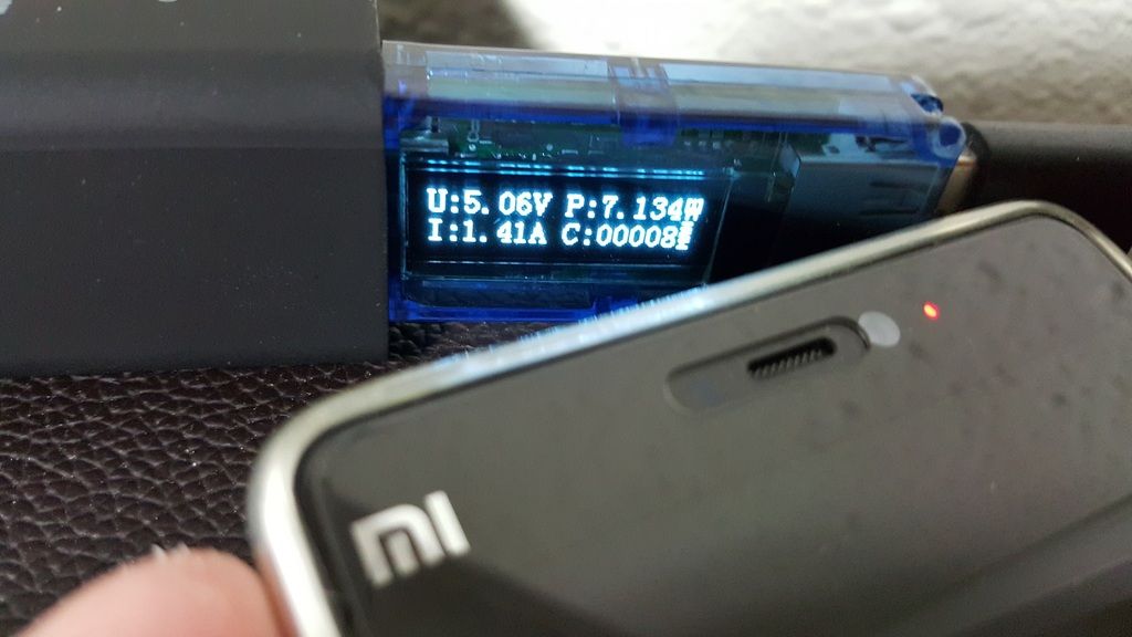

Xiaomi Mi4i
Xiaomi mi4i actually has QC 1.0. Which suppose to charge a max of 2A at 5v in theory. However it seems like it is unable to draw that much. Hence day to day whenever I'm charging this massive 3000mAh battery, it took longer than usual. And funny thing, Choetech QC 2.0 is suppose to be backwards compatibility with QC 1.0, however it doesn't seems to work, in fact it is even worse to charge on the Choetech QC 2.0 ports, it only managed to deliver 6.718w. Results shows that all 3 charges more or less the same, but Aukey managed to pull the highest among the rest at 7.27W. Thecoopidea managed to output a total of 7.205w, followed by Anker then Choetech at 7.176w and 7.134w respectively.
Anker
Thecoopidea
Choetech
Choetech QC 2.0
Aukey

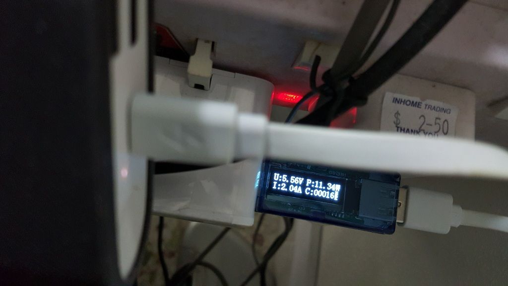

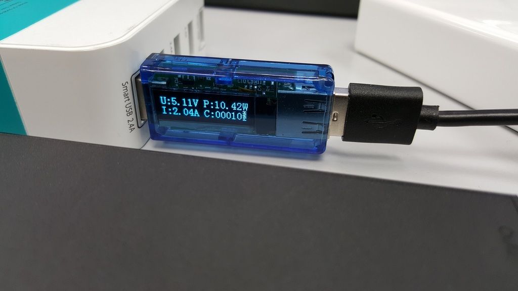

Apple iPad Mini 4
The iPad Mini 4 is one of the few devices able to take in a solid 2A. However the Choetech delivers below 2A, and hence a total power of 9.828W. Both the Anker and Thecoopidea charges the iPad Mini 4 at the same wattage of 10.31W. However the Aukey took the crown by outputting a total wattage of 10.40W.
Anker
Thecoopidea
Choetech
Aukey

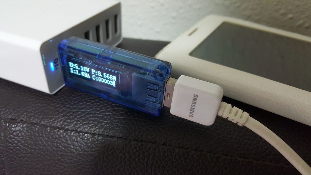

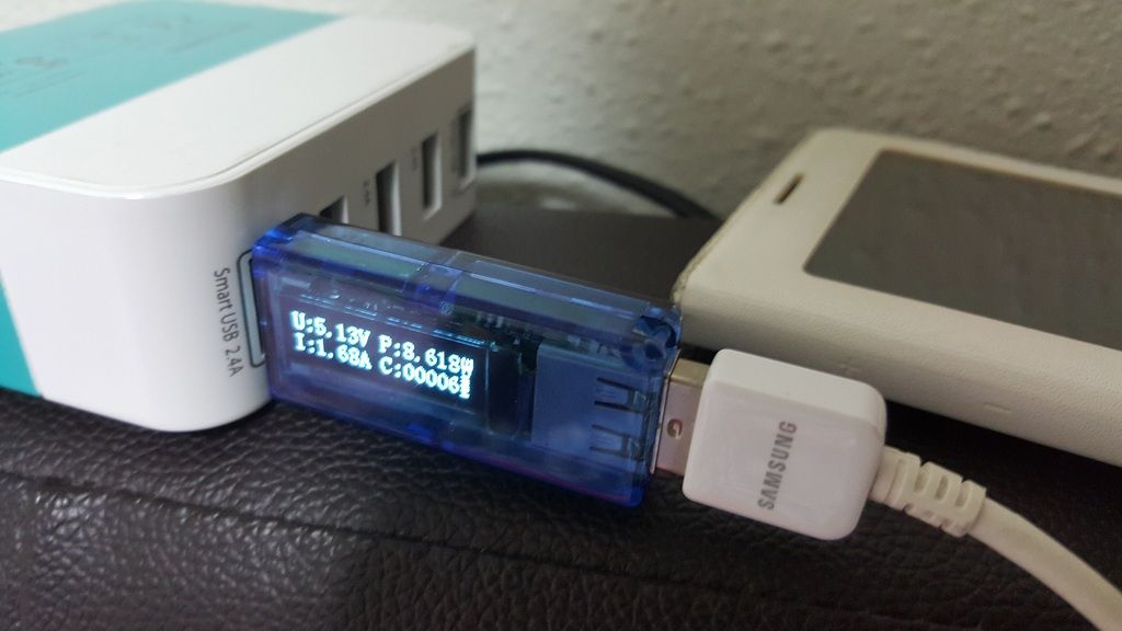

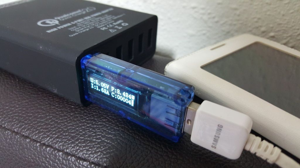

Samsung Galaxy Note 3
The Note 3 is pretty minor difference among all 3 chargers. But yet again Thecoopedia takes the crown with a total of 8.618W, followed by Aukey at 8.601W. Anker took the 3rd place this time round charging at 8.568W and lastly the Choetech at 8.484W.

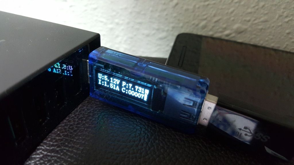

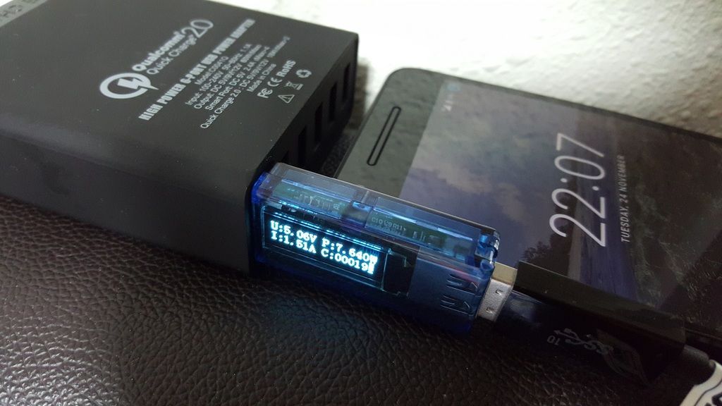

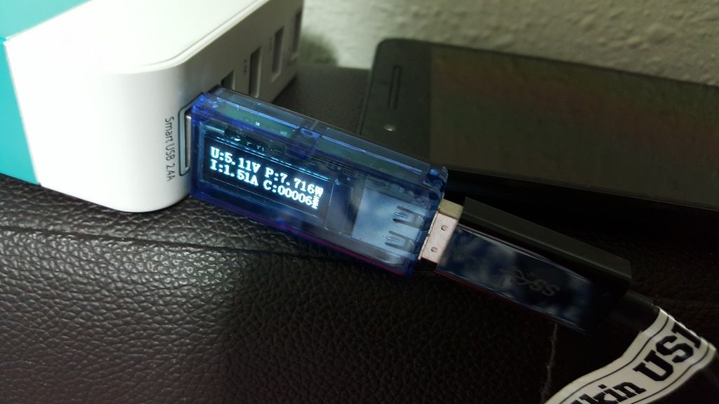

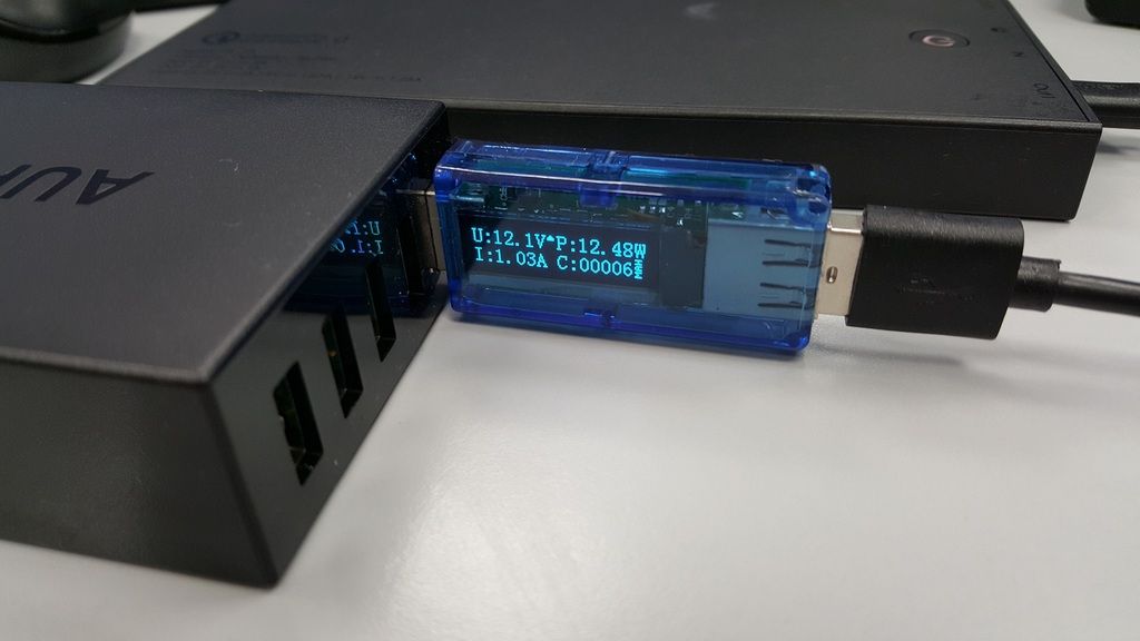

Huawei Nexus 6P
The Nexus 6P comes with a all new charging standards, USB Type C. This test is more of a USB Type A to USB Type C charging capabilities. Before i continue, read the notes CAREFULLY.
Note #1: USB Type C to Type C new charging standards can handle 5V 3A in theory. But however, USB Type A was not able to handle that kind of current amphere which will only handle 2.4A at max. So this test is more on how much can the current gen worth of multi ports chargers able to detect properly and charge accordingly.
Note #2: There is no way that Type A to Type C is able to pull more than 2.4A off the wall. It will not and it should not be. If it is so, one would risk burning their chargers. Do take note that a COMPLIANT USB Type A to Type C has a 56ohm resistors to let the device detect as there is a legacy charging method. Cables like One Plus Two that was provided does not have any form of resistors in it. And using it on the Nexus 6P with any chargers will risk frying either the phone or the charger.
Note #3: So long as there is a converter in any form to convert any USB Type C to any form of Legacy Micro USB or USB Type A, it will not pull 5V 3A for rapid charging the Nexus 6P. And this type of converter MUST be compliant to have a resistors. If not, there is a risk frying of either the charger or the device itself.
With that said, i would like to thank lionelfoo for providing 2 different Type A to Type C cable from Belkin. One of it is the USB 3.1 standards and the other is USB 2.0. Note that there is no difference in charging standards of both. But the USB 3.1 standards allow users to transfer stuffs at a much faster rate to their devices than the USB 2.0. Also note that the USB 3.1 has a much thicker wire gauge and also a much more sturdier USB head as compared to the USB 2.0.

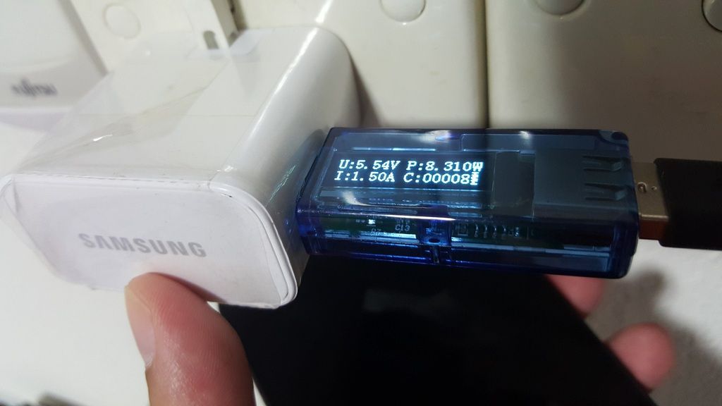

All right, lets move on to the results. Legacy charging Type A to Type C Belkin cables. For all the multi port chargers, it is a mix bag of results. The multi ports charger are not able to push more than 1.5A. But there are times when there is a detection of 2.2A. But it is rare, one have to keep reinsert in order to get 2.2A, which i'm very sure you will spoil the battery very soon if one keep doing an reinsert. But most of the time, these chargers will charge the Nexus 6P at 1.5A.
Just to make sure, i have used a Samsung traditional 2.1A charger. And yes i can conclude that legacy charging methods will only give you 1.5A. Nevertheless the Samsung 2.1A charger is able to provide a total of 8.31W!
As for the rest of the multi ports chargers, first came in the Aukey at 7.731W. Thecoopidea and Anker came in neck to neck at 7.716W and 7.071W respectively. And the last place goes to Choetech 7.640W.
Anker
Thecoopidea
Choetech
Aukey 7.731

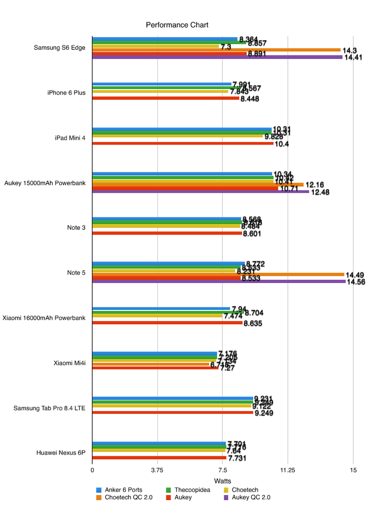

Overall Performance
Overall from the performance chart, when it comes to normal charging, Thecoopidea takes the lead with most devices plugged into it. It is still a worthy charger that managed to edge out all the other chargers.
Anker seems to be trailing slightly behind Thecoopidea. Usually in some scenarios it went close to 1W difference. Which would affect charging time to differ about 5-10mins differences against Thecoopidea.
The last one that comes in is Choetech. This charger charges worse among the above two. It was the slowest, and if you compare it against Thecoopidea, it can differ between 10mins-15mins more which is bad, really bad.
But the table turn around when the Choetech QC 2.0 is connected to a Quick Charge 2.0 devices or Samsung Adaptive Charge. Which totally slams with strong output power. And charges much much faster than regular charging. For that we can expect devices to charge 40mins shorter in time.

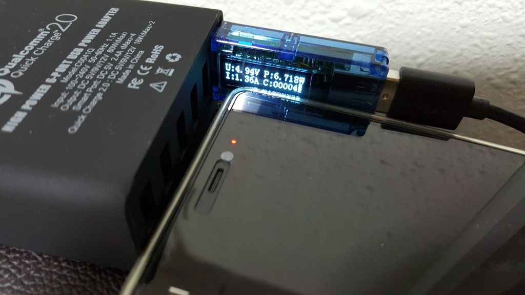

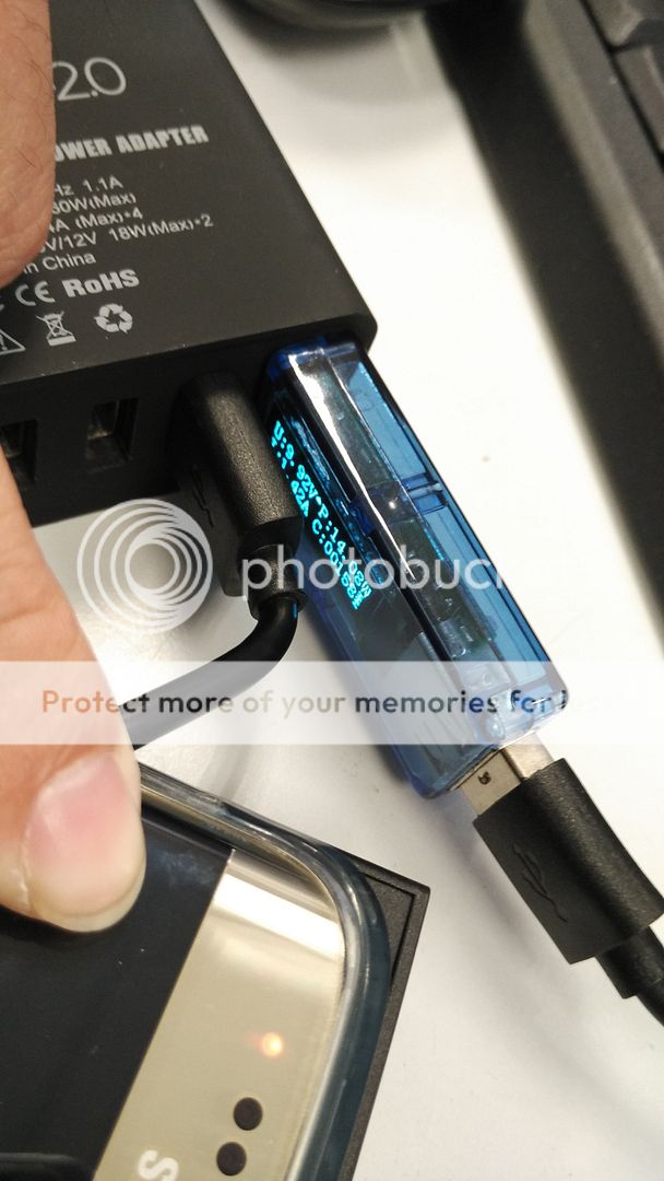

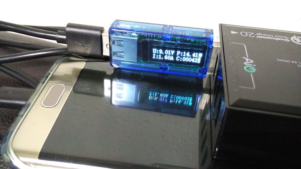

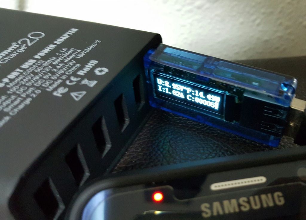

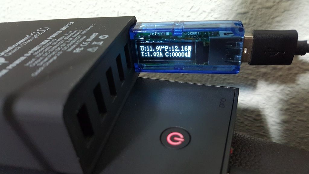

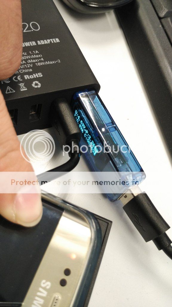

For those wondering how does the Choetech throttle in terms of charging 2 qc 2.0 enabled devices? Here is an example.
It's freaking hot to charge an s6 edge together with the Aukey powerbank. It's total output power of 26w. And it's scalding hot, hence the power output for both devices keeps going up and down.
Here is it at start...
And just 10mins.
