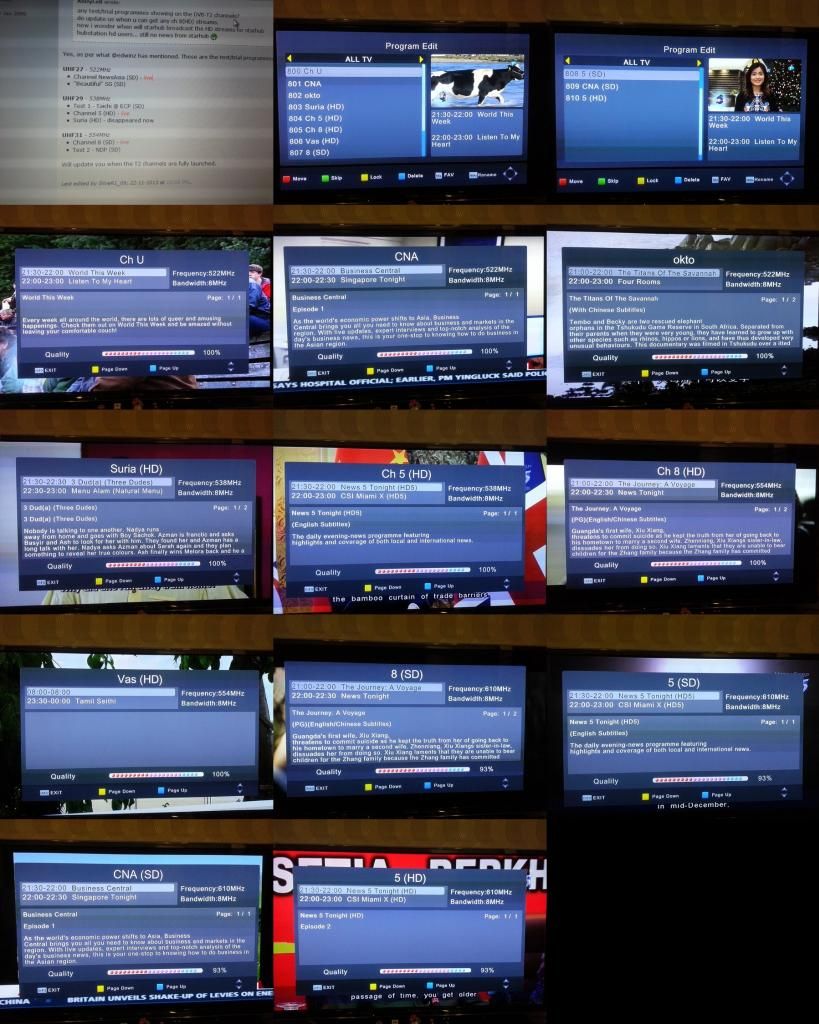

Location: Johor Bahru
Distance: 13km North from Woodlands
Device: DVB-T2 Set top box
Signal Quality: DVB-T (4 channels) -- 93%
DVB-T2 (7 channels) -- 100% :s12:
Signal Quality: DVB-T -- 93%
DVB-T2 -- 100% :s12:

yiyiday
Dec 3, 2013
28
I would like to post the picture but as a newbie it was not allowed? how many do i need to post a picture link?

Picture from @yiyiday:
