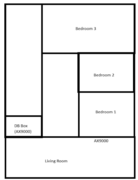

Need help on how to increase the speed of ax9000. I have been using 02 x ax9000 in a 5room flat for 1.5 years, but the internet is not fully utilized. I'm on a 2.5gbs plan and setup wired haul between the 2 routers. 1 in db box 1 on the other side of the living room, but I'm getting only 500mb in the living room and 100mb in the last bedroom. All signals had been set to max. (Both routers are on China rom)
The speed in the living room seems to be normal. What is your test device?
Xiaomi AX9000 only has single 2.5G port and you will use that as the WAN port for your main unit.
Then the second Xiaomi AX9000 will be limited to 1Gbps in terms of wired speed since its WAN port can only be connected to the 1G LAN port of the main Xiaomi AX9000.
As for the slower speed in the last bedroom, you may want to post your floor plan with details of the DB box, room LAN ports and two Xiaomi AX9000. Placement of the router is also important.

Here a sample of the layout. In bedroom 3 I'm receiving on 100mb. Will wireless backhaul increase the speed? Since my connection is 2.5gb.
