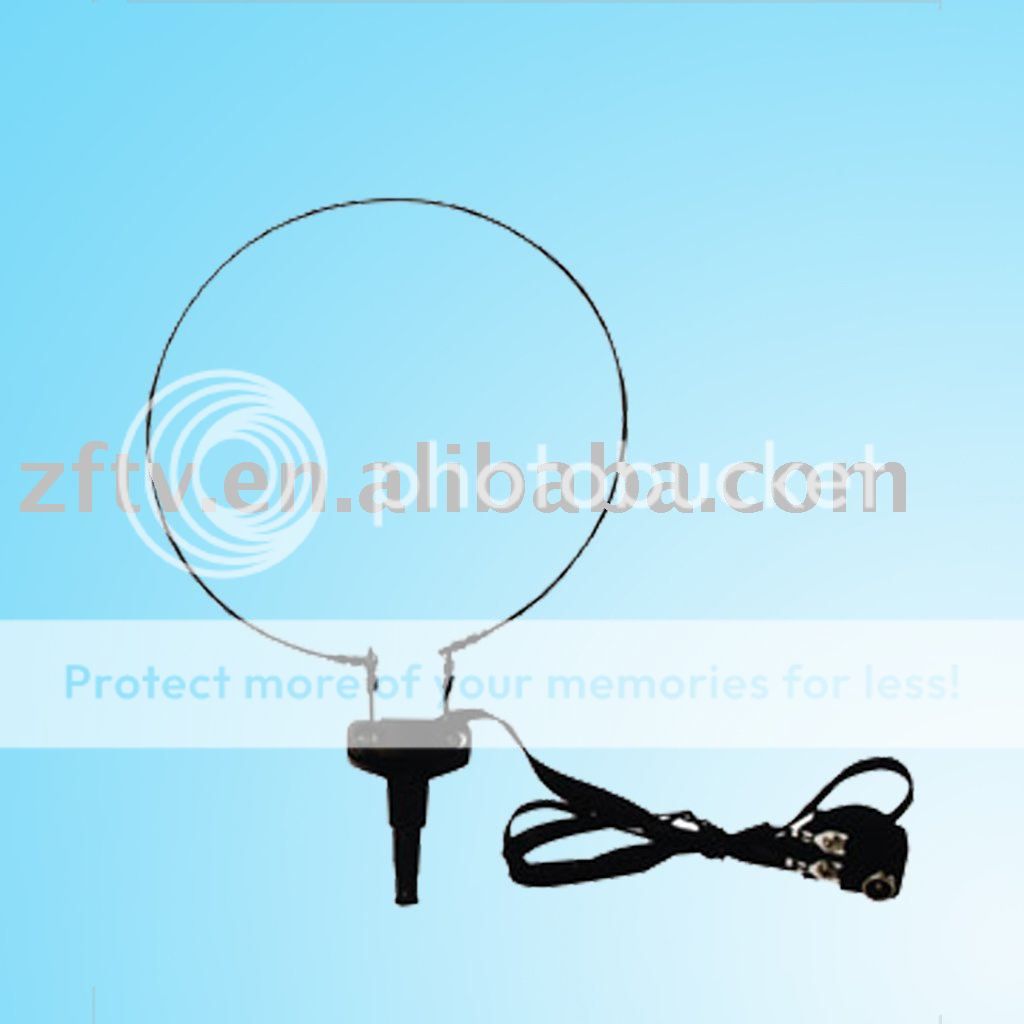

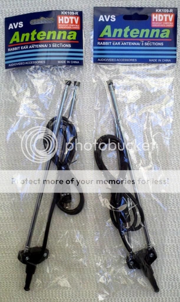

Cross post here for ease of reference:
if signal good, even cheapo less than $5 antenna oso will work
have tried such cheapo antenna with T2 b4, works fine
but the 1m long cable might be too short for some ppl, getting extension cable increase the cost, might as well get the last antenna below
