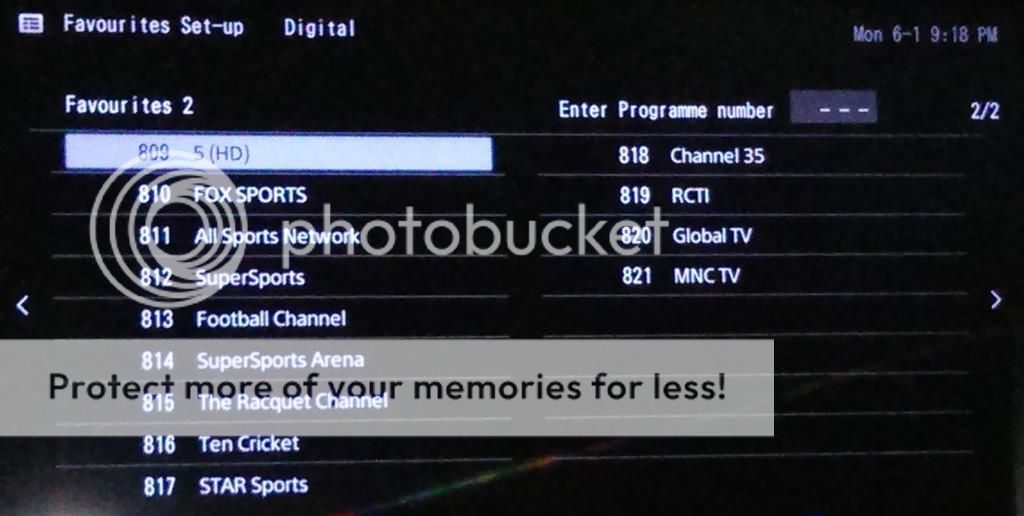

mrsun18
May 30, 2011
2,916
23
TV MODEL (and size): 40" Samsung Smart & 1999 20" Philips CRT (bedroom).
LOCATION: Bishan near Bishan Park
ANTENNA: Condo MATV & antigue indoor telescopic for testing (see picture below)
SET TOP BOX: Draco
Additional info: Perfect reception for all T2 and T broadcasts using matv (condo provided chan 38 reception when Sports/ City channel existed. Signal Intensity 99%, Signal Quality 98% throughout chans 27, 29 , 31, 33 and 38. [Hall and bedroom]
Using indoor antenna for both tv tested one after the other, 27, 29, 31 and 33 achieved SI/SQ as good as matv. For chan 38, both indicators exceeded 90%. Again perfect reception.
Tips: With indoor antenna, it is advisable to scan manually, channel by channel, in areas where indoor signal may not be so strong. The signal strength is then visually available to assist in locating the best spot.
Where the angle of antenna elements can be adjusted, straighten them as shown in the pic, with overall length about 0.25 to 0.3m. Orientate whole antenna in different angle and direction.
Use extension coax cable for more flexibility in locating the best spot.
