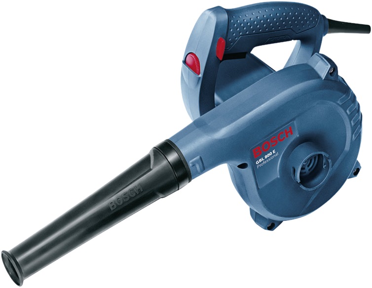

BOSCH BLOWER GBL-800E
My duaki Bosch within 5 mins my PC clean liao.
