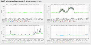

Do you all realized it?
I was wondering why connection to Europe suddenly suck..
Suddenly have connectivity issues to the the Europe NTP Pool monitors
Also to these 4 EU RIPE Atlas servers

yes, any news on this? i think SEA and Oceanic region connection to EU servers impacted quite badly the past few days
