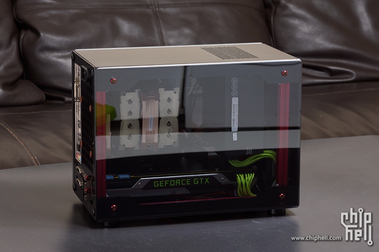

I bought the inwin a1 for a fren, gonna try build in it this weekend hopefully. Took a quick look at the case as it was delivered to my house. Built seems nice but u need to have good skills to do cable management. Space is damn limited.
Please also check on the gpu/cpu clearance. Also, if your rams are RGB, it may be blocked by the psu if the case front is perpendicular to the table edge nearest to you. Best to tilt it abt 45deg so as to see the full internals.
