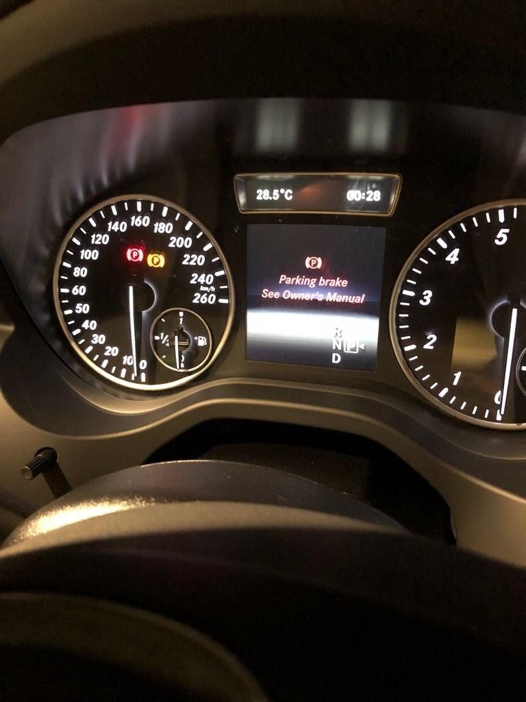

Hi everyone,
Need some help & advise here, feeling quite lost now and definitely appreciate some input from you guys.
Just collected my A180 from dealer on Tue night, it's a less than 3 years old car with 35k mileage, fully maintained by C&C and still left with 3 more months of C&C warranty. Test drive everything feels okay, but mistake is that did not send for inspection.
A day later, was out for supper and when heading back, I started the engine and about to drive off. Disengaged parking brake and changed gear to "D". Drove off for just 2 seconds and immediately there's an error saying "Parking brake, see owner's manual". There's also a lot of lights on the dashboard, including ABS and check engine light. The steering wheel became hard to steer and i stopped the car immediately.
Tried to off the engine, rested for 10 mins and on again. Error message was gone and most dashboard lights off except for check engine light (not blinking). Thought can at least drive home, but just 5 seconds later the same error message came out and dashboard lights on again.
Was 2am, called my dealer and was extremely pissed off. 2nd day of getting the car and this happen... Dealer was responsive, rushed all the way down and get tow vehicle to go back C&C workshop. Today is PH, so only Friday can get it checked up. Dealer agent kept reassuring that it's just sensor spoil and nothing serious because low mileage car + fully C&C maintained.
Now, question is that I'm already feeling insecure & paranoid over the car because problem came up just on 2nd day. Dealer agreed to hold on to the ownership transfer till this is resolved.
Does anyone experience similar error message before? Is it really just sensor fault or this could be a warning to something more serious eg. gearbox faulty? Any advice for me - I can try to ask for an exchange to another A180 with similar spec (test drove both, but was more comfortable with this condition and hence bought this). If C&C checked and fixed it, can I still continue with this car?
Will appreciate any form of opinion & advice. First time buying 2nd hand car, and really feeling lost now.
Cheers guys!

Most likely the ABS module gone case liao.
Is the speedometer still working?

Yes, the speedometer is still working. There is also a check engine light on... so i was worried about gearbox too.
If the problem is with the ABS module, you will also lose the speedo reading and fuel level reading. And also no ABS. On top of what you are facing now.
One problem will lead to another one.

It could be just a wheel sensor issue. Besides, it still has 3 months C&C warranty.
Wheel sensors on Contis are known to go kaput. At least for VAG cars is just 100ish per replacement.
Ahh I see, so probably not ABS module right? Since the speedo and fuel level reading was okay.
If it's just sensor, then I tihnk I'll keep the car. Just hope it's not any major issue!
the problems don't come altogether at once.
it will start with the ABS check light.
if you keep ignoring it, you will see more Xmas tree lights on the dashboard. :D
do a ODB check. it will pinpoint the exact problem.
