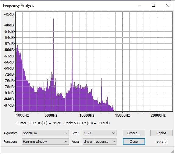

I went through a similar issue and can pick up the noise anywhere there is a power point in the house or at every single Power meter down every corridor too.
its a 5333Hz signal that intermittently comes and goes all the time. my hears it on speakers but I dont.
could be the lifts or maybe solar inverters perhaps...happened at my old block too
http:// walaneh.com/xpl/noise0002.wav
http:// walaneh.com/xpl/noisesound.wav
remove the space after the //
see the peak in the waveform analysis
I listened to your recording, and that is exactly the noise I am hearing, and the changes in pitch and volume at varying times as well.. I am very sure it is coming from the lifts, and if you are able to test it in the dead of night when lift traffic is low I am quite confident you would not hear the ringing (buzzing would be due to grounding though).

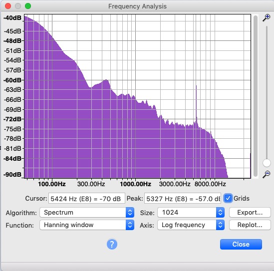

I have posted a recording of the waveform before as well, with peaks at roughly 5300hz and 8000hz:
Some lifts would have it, some would not. The noise reduces but never completely goes away as shown in my video in earlier posts:
