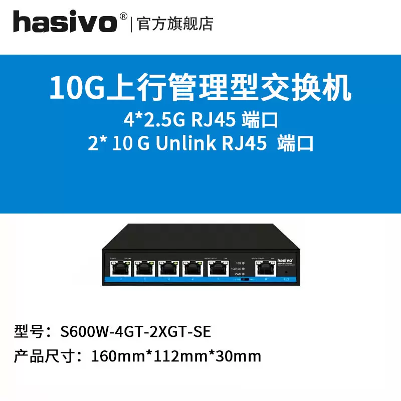

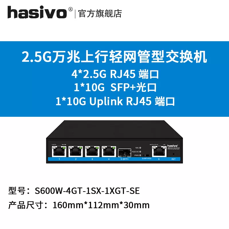

Cheap Hasivo 2.5G switch with one or two 10GBASE-T RJ45 ports.
S600W-4GT-1SX-1XGT-SE: RMB 399 plus shipment plus GST
S600W-4GT-2XGT-SE: RMB 499 plus shipment plus GST
The comments say they are very hot so you may need a fan to cool it down. I was thinking of buying the first one to use with mini PCs with SFP+ ports. Now I will carry out more research first. I am buying a few 8010 fans (using one 8010 fan with my Intel N100 mini PC with quad 2.5G LAN ports now).
Taobao link:

It is common for SFP+ to be very very hot. I ran such setup for 2 straight years without issues so don't really need to cater cooling for that.
