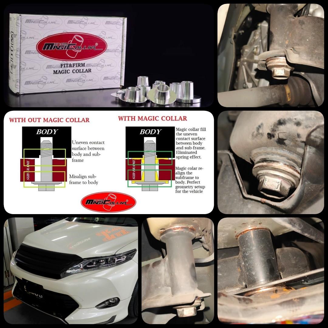

For purely aftermarket options besides changing to coilovers, there's also something called "magic collar". Originally developed by Spoon, other companies have since stole the idea. Basically semi soft metal "washers" that fills in the small gap between the wheel structs to the chassis. These gives the bolts a snug fit to reduce the slight lateral "shifts". The type of shifts which drivers may experience when the bolts move around in the larger bolt holes in the chassis.
Manufacturers normally drill holes in the chassis which are a tad larger. This is so that they can easily fit the bolts through. Then the use normal flat metal washers to kiap the bolt to the chassis. Due to this small gap, the bolts can still move a bit.
It's sort of like a screw that is a bit smaller than a drilled hole, due to the gap, it can shake a bit.
Magic collar is like those plastic plugs we push into the drilled hole. When the screw goes in, the plug fills the gap, and the screw won't have gaps to move.

I bought China made magic collar for cheap (less than $100) after someone in my car group swore by the China ones being more comfortable than swapping to his coilover. Managed to get a workshop to install for $50.
I felt the improvement, but though maybe coz I paid for it and was biased. But wife confirmed definitely can feel improvement, that's good enough.
Stealing pic from Carousell to have a better understanding of what I meant by it being similar to using those plastic plugs for screws. Of course, looking at the price, I can tell the Singapore workshops are all buying the cheaper non Spoon ones and just charging a premium:
This one is confirm cannot transfer to new car. Personally I won't buy if my car less than 1 year left.
