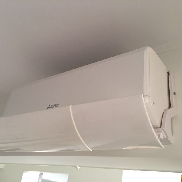

this is why some ppl will buy deflector....
this aircon very creative tho
