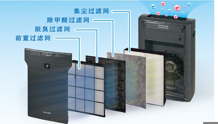

They do sell the replacement filters online on taobao. All sorts of quality for you to choose. H12 or H13 is more than sufficient for home use. In fact do not worry too much about H11/H12/H13 used in air purifiers for PM2.5 or hazeuse coz the difference is very very small, the volume airflow makes a much bigger difference.
It's this machine, the equivalent model in China. Feast yourself to the write-ups and pics. :)
FU-A420S-B_

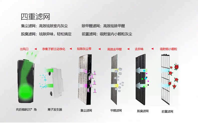

The same seller as I recommended above, uses H12 PP filter media. rmb164. It's quite a big filter. 390mm x 285mm x 37mm.
ÏÄÆÕ¾»»¯»ú¹ýÂËÍø×¨Òµ¶¨×ö(ÊʺÏFZ-180HFS/FZ-240HFS/FZ-A420HF)-ÌÔ±¦Íø
