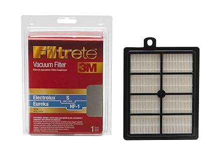

I still have a KC-840/A40 True HEPA filter (the filter is for the A40 but fits KC-840 as well....and possibly the D40 also) in the storeroom. :D
Gonna measure my Philips vacuum cleaner with 3M 99.9% filter that i bought from Amazon. It is equipped with a H10 Philips bag (85%) + H12/H13 (99+%) 3M-based exhaust filter. Should be pretty tokong in filtration since it's double filtered.
S-bag
https://www.amazon.com/gp/product/B0000V6Z12/ref=oh_aui_detailpage_o08_s00?ie=UTF8&psc=1
Amazon.com - 3M Filtrete Electrolux S / Eureka HF-1 HEPA Vacuum Filter, 1 Pack - Household Vacuum Filters Upright
