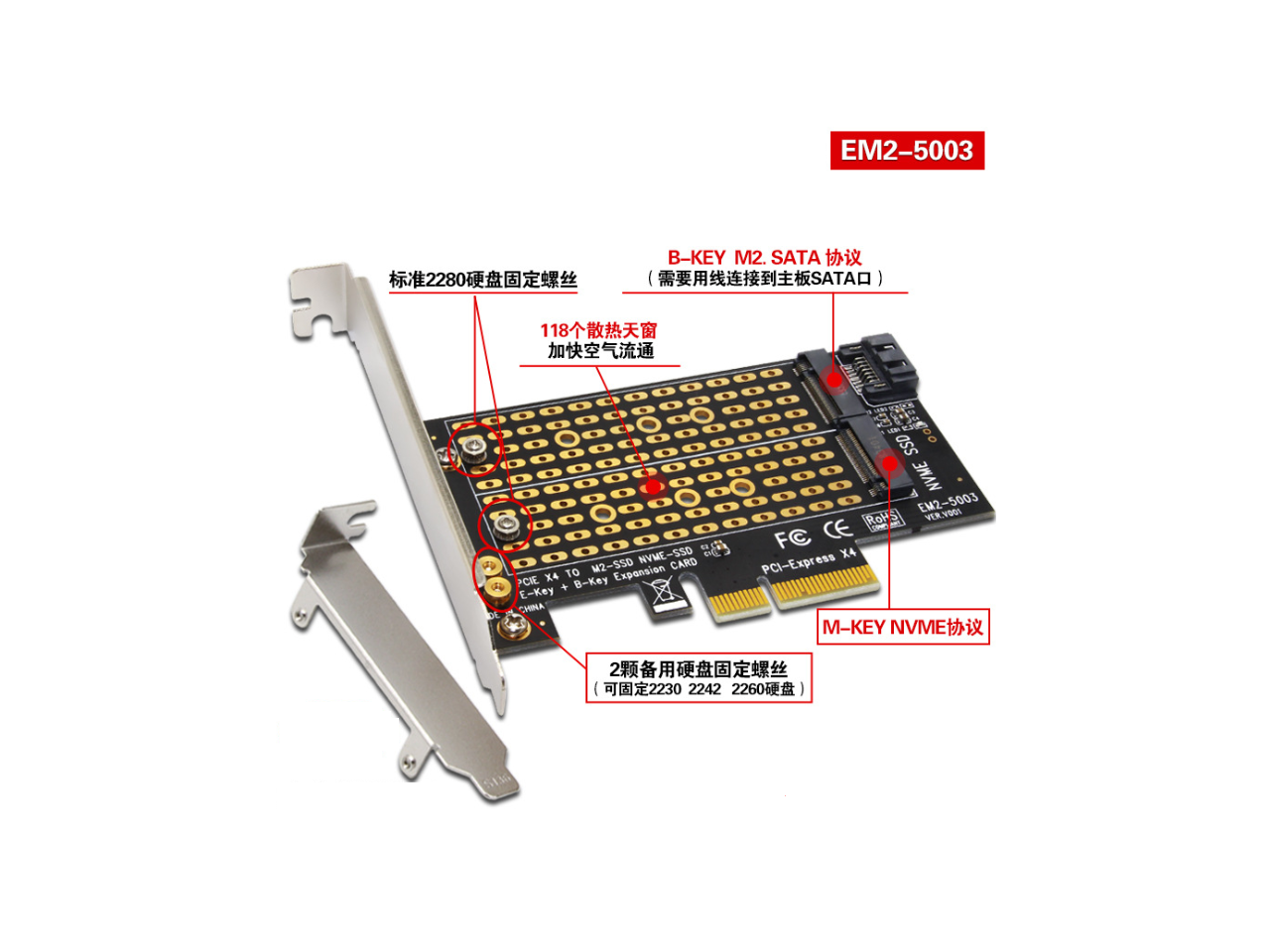

anyone use such card before?

i understand when u plug in to the pcie slot it should detect a drive so the sata port is for what purpose? connect 2 diff drive with the 2280 use sata as transmission?:s11:

weird though.. this is x4 but give u 2 m.2 slot.. like that won't bottleneck? :s11::s11:

the card m.2 one is for nvme and the other one is for sata.. you can zoom in to see the port cache is slightly diff..

that i know but Sata port is for what reason?
i have the silverstone ECM20 card, similar feature.
1 of the slot is M key, using the pci-e interface. (NVME)
2nd slot is B key, using the sata port , connecting via a sata cable to the motherboard sata port. (M2 sata)
This card support both NVMe and SATA M.2. if you are using the SATA M.2 slot, you need to plug a SATA cable to motherboard SATA port.
