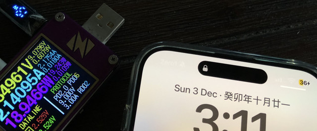

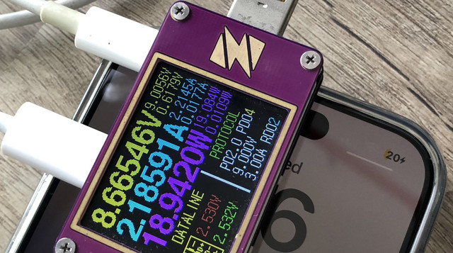

Found an original MagSafe charger from Apple to play with. It can exceed 15-watt charging but from my testing you rarely see so when the phone is above 40+%-charged already. To make things more confusing, I believe it makes a difference between:
1. you start charging when the phone is at low-charge level, e.g. 20% and then you leave it charging, versus
2. you start charging when the phone is not that low, e.g. 30-40%
For the 1st, you will see it go from 18-19-watt then taper the wattage downwards to 10-watt around the 30-40% mark
For the 2nd, sometimes you see it directly start and remain at 18-19-watt even when it's already mid-30% charged.
It's as if the MagSafe charger logic is like:
"the moment I start giving out >15-watt, continue throwing out this high-wattage for a while, even if the phone batt is at a charge-level that I will not charge at >15-watt if I started from when it is low."
Convoluted I think...
I will say conclusion: even the Apple one will, on average, stay around 13-watt charging when the phone is <50%:
That said, even at 13-watt charging the back of the phone and the MagSafe charger itself gets hot to touch; I'm uncomfortable subjecting the phone battery to such high-heat charging for sustained periods.
