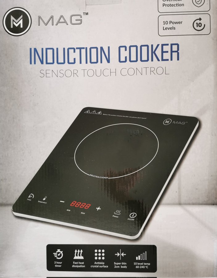

Bought a low SES portable induction stove

It can only function when I use a big frying pan.
If I use small pan, the stove have error code which said no pan on the stove and cannot work!

Any picture of your low ses induction cooker? :o

Ur small pan, u put magnet on the bottom can stick or not?
If not then the metal type cannot be detected by induction cooker leh

Some of the aluminum pans that claims to be induction compatible use a thin steel plate embedded into the base. Maybe the small pan steel plate is too thin.
