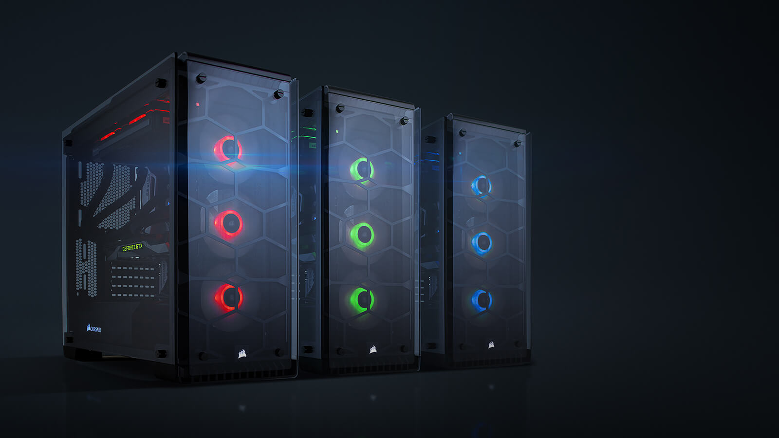

Corsair Crystal 570X
Warning: 280mm RAD Does not fit on top of the case. Rad will collide with the ram just like our MRTs.
Already include 3x 120mm RGP fans. All Tempered Glass. Great Airflow. Out of Box Thermals are great. Need 1x Rare Exhaust fan and its set. Edit: No Go.

May I check if Corsair H100i v2 (240mm) is confirm cannot top mount with G.Skill - Trident Z RGB in Corsair 570X?
