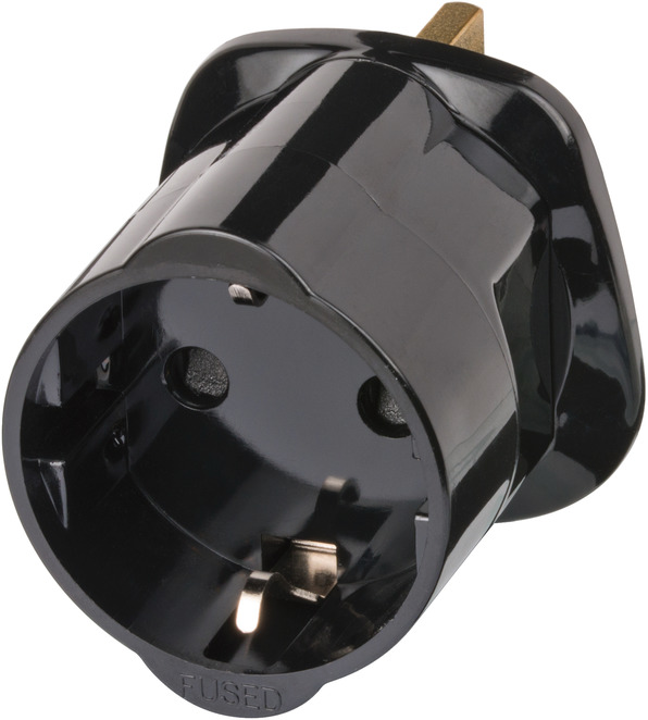

hardware shop got sell adapter, using this kind adapter many yrs ago
last time saw in home fix, now closedown not sure

Thanks for the explanation guys. I'll get an electrician to come over to get it done since the oven is too big to be carried out.
It is better to connect to a proper plug.
Do not use adaptor, because it is an oven. most likely the adaptor will be overheated.
adaptor is suitable for low power devices.
