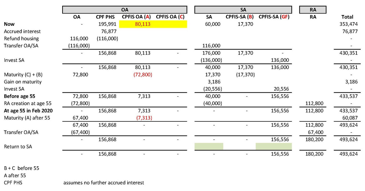

Dear BBC, Kelhot, Henry, Deluxe, all the GEGE and Experts:
Let me RECAP and Organise it better again. Shall I make any mistake, pls do not hesitate to guide me along . My uncle also sharing with his classmate, pressure lah..:s13:
Now My Uncle have :
OA ZERO
SA 60,000
MA 31,000
Withdrawal for properties (OA:195,991 + 76,877 Interest + SA:17,502 + 3,186 Interest)
His CPF indicate that he used for Investment:
OA 80,113
SA 17,370
.... Which he use to purchase NTUC INCOME
(A) GROWTH CV 67,400 Mature 3/2020 from OA [Mature 2 week after his 55 birthday]
(B) GROWTH CV 36,300 Mature 2/2020 from SA [Mature before his 55 Birthday]
(C) HARVEST CV 72,800 Mature 3/2020 from OA [Mature 2 weeks before before his 55 Birthday]
He and spouse are covered by Enhanced Incomeshield Preferred
What he need to do immediately PHASE 1 now is:
1. Top up 116K to OA (to pay back his Hse OA). Current SA limit of 176k – 60K he has in SA
2. Immediately request 116K OA transfer to SA
3. Immediately use the 136K SA to get Lion Global All Seasons Fund – Standard via Peom
• He is working oversea, child in NS, hence no one could benefit from the Tax Relief Top Up?
Then, before he turn 55, maturity of his two NTUC Investment Policy (B) + (C) would go back to CPF become:
OA 72,800 (From C) …. Matured 2 weeks before he turned 55 .
SA 40,000 + 36,300 (From B) …… Matured in Feb 2020 before he turn 55
MA 31,000
Withdrawal for properties (OA:79,991 + 76,877 Interest + SA:17,502 + 3,186 Interest)
What he need to do later in PHASE 2 before turn 55 is:
1. Once NTUC (B) Maturity back to SA during Feb, Immediately use it to get more Global All Seasons Fund – Standard via Peom
2. Top up 136K to OA (to pay back his Hse OA+Interest). Current SA limit of 176k – 40K
By 54 Birthday:
OA 72,800 (From C) + another NTUC (A) 67,400 [Mature 2 week after his 55 birthday]
SA 40,000
MA 31,000
Withdrawal for properties (OA:20,868 + SA:17,502+3,186 Interest)
>>> This would sufficient for FRS 181K
>>> In fact, he may Top up his OA Withdrawal for properties (OA:20,868 + SA:17,502+3,186 Interest), then transfer this excess amount to Top Up his spouse CPF for her to have better retirement payout?
By 55 Birthday :
OA ZERO (Transferred to RA)
SA 308.3 K (Sell off all his Lion Global All Season Fund, back to SA). ***
MA 31,000
RA 181,000 >>FRS
*** Question: This SA would exceed the max 176K, he could transfer to her spouse SA?
Before 65 Birthday:
>> IF he think , still fit to enjoy more years, Request CPF Defer Payout to 70
>> Choose STANDARD PAYOUT :
- As he could use his hard earned money this life
- If uplorry before 81, the balance FRS minus the cummulative Payout would left as bequest to family.
- If live beyond 81, cumulatively payout he has taken 259-287K more than his FRS (Based on CPF LIF Estimator), which is fair no more bequest for family. But he continue to get Standard Payout of 1.4-1.5K/Mthly till he happy to go.
Did I understand correctly and could execute this plan accordingly? Thank you all Expert's Guidance and Patience =:p

Before 65 Birthday:
Oops, the revised CPF Life Calculator information succeeded in convincing the layman!

Oops, the revised CPF Life Calculator information succeeded in convincing they layman!
(need to find uncle henry's table and post here)
you are really not simple, this guy posted so many things, yet you can detect the trash in it

Cannot understand your numbers.
Need to rephrase and provide more info or correct info for numbers in red.
maple96
Apr 25, 2017
2,225
6
He is very confused, u cannot take his figures or process.
U have to take all the base numbers and propose the solution/process to him!
BBCWatcher
Jun 15, 2010
24,663
5,635
I’ll repeat. There are only three things to do now:
1. If anybody qualifies for tax relief (your uncle or one of his immediate family members), make a $7,000 top up to his Special Account for the tax relief. That’ll bring his total SA deposits to date to $60,000+$17,370+$7,000=$84,370.
2. Repay $91,630 of OA dollars used for housing into his OA. How did I get that number? That’s equal to the current (2019) Full Retirement Sum of $176,000 minus $84,370 (his total SA deposits to date, including the $7,000 for tax relief). He should be able to check this number right now, online in his CPF account — or stop by a CPF customer service office and ask “What’s the maximum top up amount I can make to my Special Account now?” He should see $98,630 right now if the numbers you’ve reported are accurate. (The $7,000 top up for tax relief in Step #1 reduces that to $91,630.)
3. He transfers those $91,630 OA dollars into his SA.
That’s it for now! Everything else can and probably should wait until a month or two before his 55th birthday. Unless he’s sitting on a pile of cash that’s earning less than 2.5% interest, in which case OA at 2.5% is mighty attractive to a 54 year old. So he can repay more than the figure in step #2 if he wishes, if he’s just got lots of cash rotting in a bank account at low interest.
What these steps accomplish is to max out the deposits he’s allowed to make to his SA, and that SA is earning 4%, starting from April 1, 2019, if he gets these steps done and credited this month (March, 2019). That sets him up very well indeed for early next year’s maneuvers. We then have the next 9 months or so to discuss those maneuvers, plenty of time.
