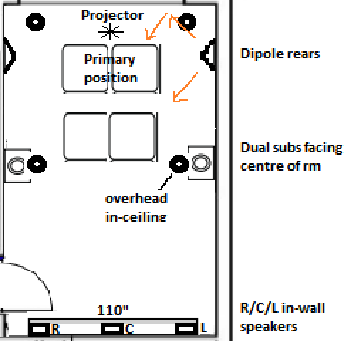

I think my final layout will be something like this (5.2.4) for my 3x5m rm
- Front R/C/L diagonal in-wall behind acoustic transparent screen
- 110" inch screen (could go 120" but after consideration of front seating positions, i think 110' is good enough). Tested a few immersive showrooms, didnt really gel with too big a screen.
- Dual 12" ported subs at 1/2 side wall facing inwards (still contemplating if should just go smaller 10" being less bulky/pricier and room isn't that big to begin with. Also considering noise pollution to neighbours which at this point is unknown how well they take it)
- Rears abit interesting, figuring out maybe dipoles could be a good choice to suit both front and back positions.
- 4 in-ceiling. Think they're a little far back in the room, but just adjusting for the primary listening position.
benedium
Jan 22, 2005
12,460
3,711
Not sure if in wall speakers are any good. With big bookshelf speakers crossed over to subwoofer at 80hz, you can kind of feel the bass texture in male voices. Maybe like some say, there's no replacement for displacement? Although I read some say just get thx certified then it's OK.
