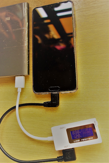

rty
Apr 7, 2001
1,685
Mi Powerbank actually is not bad. It's not a Super charger, but it fast charges P20 at 9V 1.28A. This model of powerbank is a bit dated (PLM03ZM). The latest model (if not mistaken PLM05ZM) could probably charge faster.
