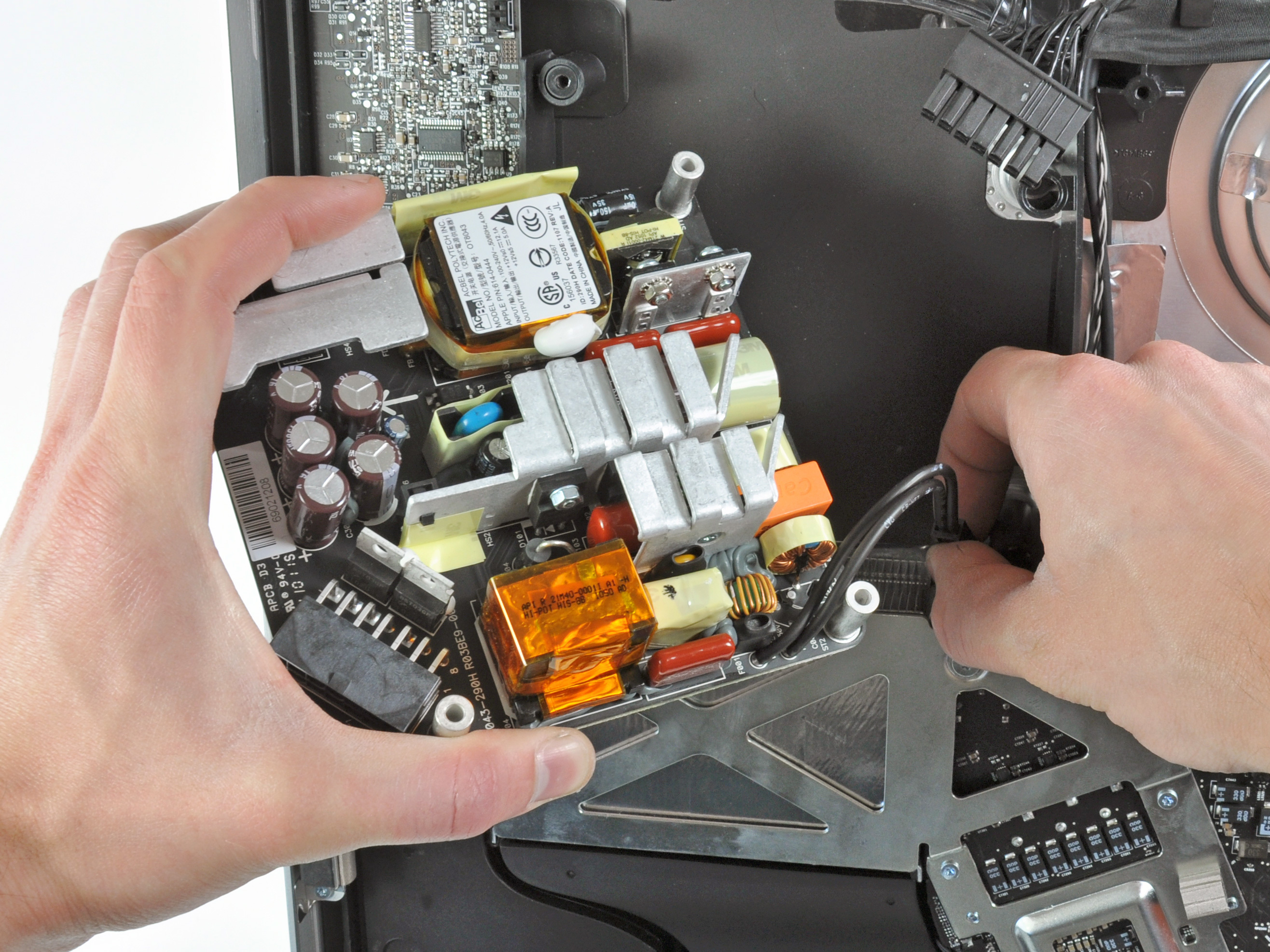

I don't know what the internals look like, but I'm guessing yours is the same model as this?
https://www.ifixit.com/Teardown/iMac+Intel+21.5-Inch+EMC+2428+Teardown/5485
If so, your power supply should look like this:
wFZcHBWwLsHQQge1
Then if you're lucky, one or more of the brown cylindrical things on the left (capacitors) will have bloated tops, indicating that they're failing. It will be trivial to buy new ones from eBay or Sim Lim Tower and solder them onto your power supply, and they shouldn't cost you more than $10.
If those capacitors look fine then perhaps your power button just needs some cleaning because the contacts are not connecting properly.

Wow.. thanks bro.. i will chk on it.. it's getting bad to worse except that with patience it will start..
