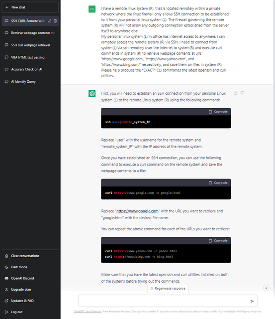

peterchan75
Apr 26, 2003
6,754
533
Why not you try ? As long as the solution can work. Looking forward to it. :)
I try with chatGPT and here is the response.
davidktw
Apr 15, 2010
13,550
1,302
I need to install the Windows Sub-system for Linux 2. :oops:
The ChatGPT solution is just simplistic executing command via a SSH session. There is nothing special about it.
It wouldn’t solve the challenge I set.
Read my solution properly.
