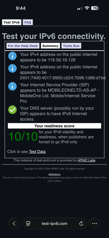

Test again for M1 Maxx Base Plan in 4G mode on an old iPhone 7+, IPv6 is working.
Your IPv4 address on the public Internet appears to be 119.56.xx.xxx
Your IPv6 address on the public Internet appears to be 2401:7400:xxxx:xxxx:xxxx:xxxxx:xxxx:xxxx
Your Internet Service Provider (ISP) appears to be MOBILEONELTD-AS-AP - MobileOne Ltd. Mobile/Internet Service Pro
Your DNS server (possibly run by your ISP) appears to have IPv6 Internet access.
Your readiness score
10/10 for your IPv6 stability and readiness, when publishers are
