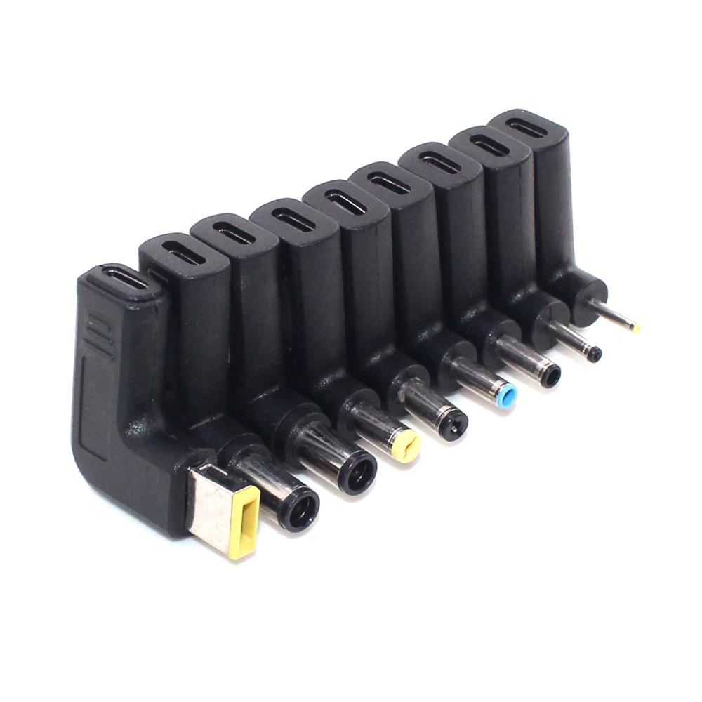

I saw this item. Anybody tried ? Does it mean that I can just get a generic Type C charger with sufficient power and connect to the laptop via this adapter ?
Will damage the laptop ?
Thanks very much for any advice in advance.

But my laptop is Asus and I understand does not support Type C Charging. So I use the adapter with this GaN charger (via Type C), it will work ?
Have you tried this adapter ?
Thanks...

That is why the adapter you found exist lor. It is your Type C port that is unable to draw power and charge. So you will need to get the adaptor in order to plug your cable into the normal charging plug port.

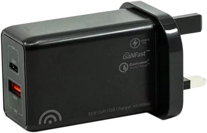

I just got a Prolink 65W GaN charger, very compact and has two USB-C and one USB-A port
it comes with US / UK / EU plug
pair that with a USB C cable that can do at least 65W (say 100W), then you could charge the laptop but it depends on how much faith you have with the el cheapo USB C -to-barrel plug adaptor that you showed in the 1st post

it wont damage your laptop. its a cheap way to get usb c charging without the disadvantage of it getting loose over time
