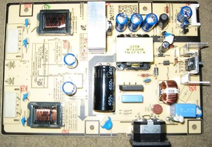

If logic board failed then nothing can be done.
If power board failed then there is a chance that the capacitors have failed.
Open it and see if there is any bloated capacitor(red arrow).
If there is bloated cap, take out the board and bring it to Sim Lim Tower. It cost less than $1 per piece.

Thanks for the all suggestions.
Ima try to open it up and check for the defects.
Many thanks to peterchan75 for the useful pics!

Important ! Use your handphone and snap some pictures before you desolder the bad capacitor. It important that you put back in the same polarity. Put in the wrong polarity, it will pop.;) It's power board that you are dealing with. :D
