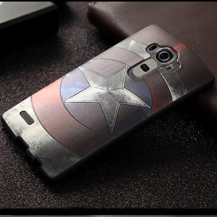

https://detail.tmall.com/item.htm?id=520865274187&toSite=main&skuId=3104025409047
found this link selling nice covers.. anyone bought before?
