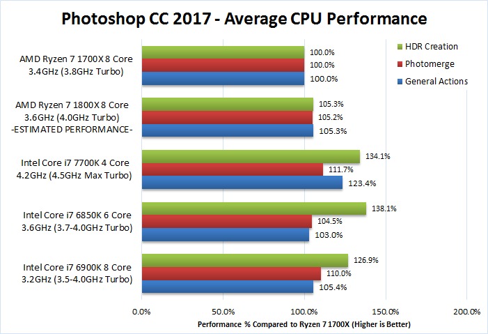

pic_disp.php
https://www.pugetsystems.com/labs/a...2017-AMD-Ryzen-7-1700X-1800X-Performance-907/
In this case, the logical direction is the 7700k. Those Broadwell-E processors don't do well either.... especially for their price :eek:
