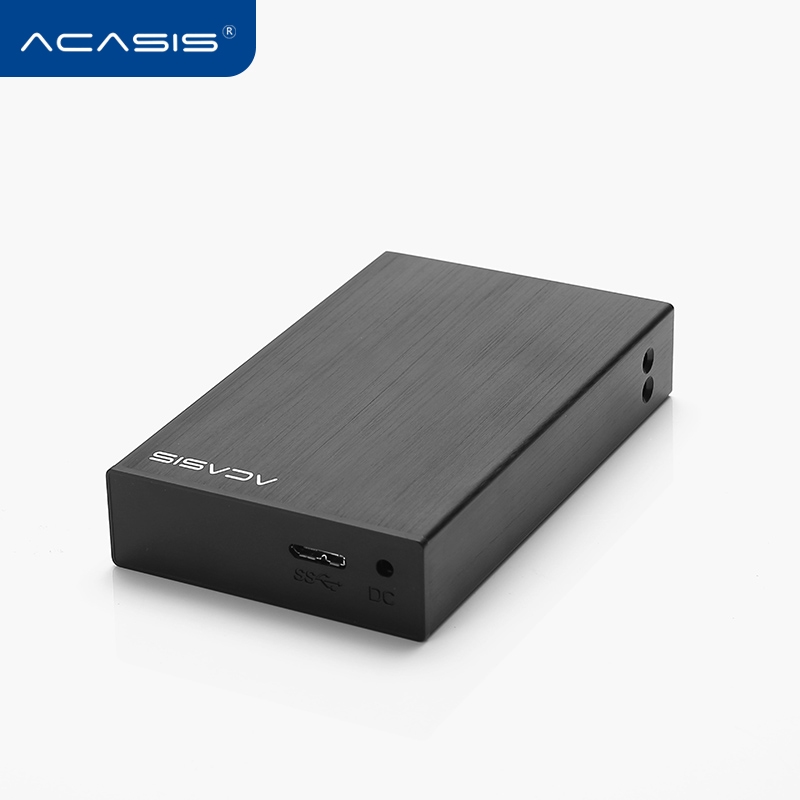

Share with you Entry Level PC Raid1 Setup.
d14540e0ed2ce16ab92058ce7b37069b
HDD Enclosure ~$30
ACASIS usb 3.0 2.5 inch SATA HDD RAID enclosure Double HDD Enclosure with RAID function disk array usb3.0 dual hard disk box for 2.5
https://shopee.sg/ACASIS-usb-3.0-2....II-HDD-Up-to-10TB-Intl-i.266366546.6838253567
Moi use 2x 1TB HDD Raid1 with this Dual 2.5 inch Enclosure.
1) Small
2) Portable
3) Low Power Usage
4) USB Powered.
5) Support up to 5TB Raid1.

:s12:
HDD Enclosure ~$30
1) Small
2) Portable
3) Low Power Usage
4) USB Powered.
Wow. Didn't know got this kind of enclosure/case. :eek:
Thanks for sharing. Will try to get up more.
