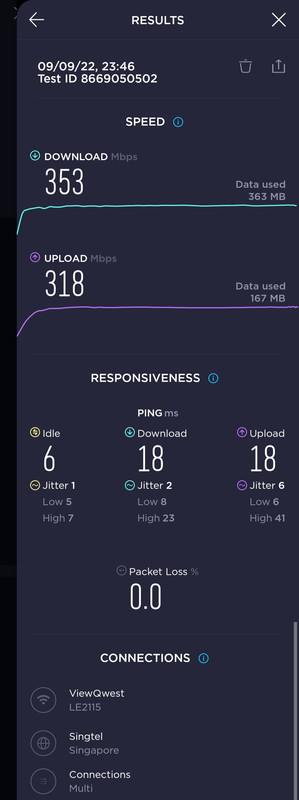

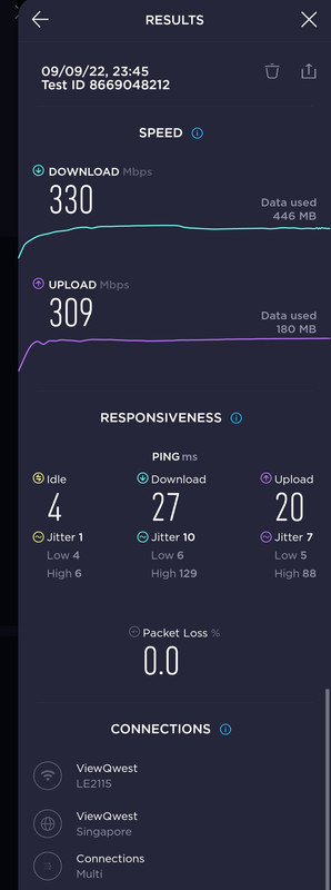

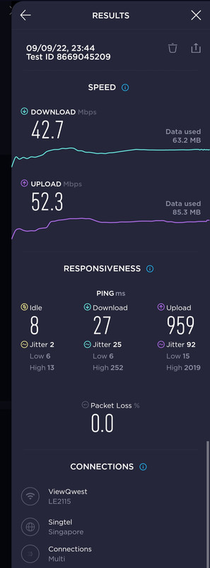

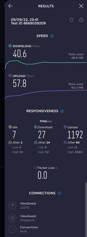

nope, it's currently OpenWRT 21.02.3 on my EA8100
these are the results of 2.4GHz vs 5GHz done on my Oneplus 9, distance from router is about 2 meter
ISP is Viewqwest 1Gbps
seems like 2.4GHz speed is similar to yours
