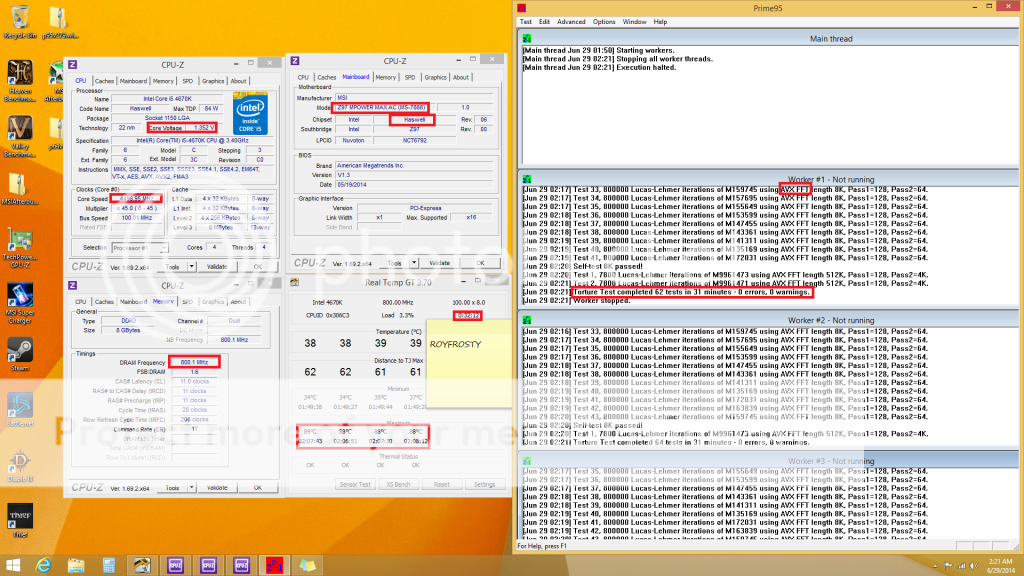

Same cooler used in my current test bench.
H100i
MSI Z97 MPower MAX AC
Delided i5-4670k with just a normal MX4 Thermal paste.
OC at 4.5ghz with actual voltage of 1.34v measured from multimeter.
Shaving off at around 4-5deg differences.
If I set it to 4.4ghz at 1.285v with MX4 thermal paste I could get at 83deg.
With that said. Delid does help reducing the thermal heat, and probably with the help of good Thermal Paste such as CLU which is conductive would further reduce the heat output to about 7Xdeg on load.
