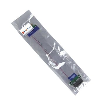

Hi,
does any of the bros here know where to sell this item in Sim Lim Square?
As i am running on Asus GTX 980ti 2 way SLI and I have a Asus Soar Strix Soundcard in between. I want to move the soundcard to the last PCIe slot but my Graphic Card is in the way and current cause my 2nd card's heat is higher than the 1st card..
Wanted to improve the ventilation of my set up..
Thanks

Try Worldwide Computer at 6th floor facing lifts, SLS.

Have you thought it through? Your casing only has 7 PCI slot openings, where will the sound card go? I have actually done exactly the same thing, and even with sufficient PCI openings, this cable will not work, as the female end of the socket will interfere with the base plate of the casing where the motherboard is on. You will need a 90 degree PCIe connector, plus this cable.
And in any case, you can quite easily find this cable in SLS.

I am actually worry about the male that connect to the mobo. As the 2nd PCIe 1x slot is very near to my 2nd 980ti's heatsink pipe. It will not interfere to the base plate of the casing if i put it to the last slot the place where i secure my vga using screws. The last slot is outside the base.

are you talking about this?
http://www.lazada.sg/oh-new-pci-e-pci-express-1x-adapter-riser-card-90-degree-for-1userver-chassis-intl-4723451.html

oh I see, so you have 8 PCI slot openings for your casing? you have a rather unusual case, so I am not sure what the physical contraints are. if putting the soundcard in the 8th slot doesn't interfere with the base mounting plate for the mobo, then you may not need the 90 degree joint.
yes.

like i said.. the 2nd PCIe 1x slot is directly below my 2nd VGA 90 degrees PCIe expansion will touch the hitsink of my 2nd card i still do not know yet T.T
And yes i have an 8th slot for my casing.. my casing is Inwin D Frame

i have tried.. the riser is in the way of my 2nd sli card.. hence had to remove the sound card.. damn..

what do you mean by in the way? as in the ribbon cable from the riser touches the GPU shroud? if it does, it doesn't matter, both items are insulated. my riser cable is in the 2nd PCIe1x slot, and my mobo's PCI layout is very similar to yours. no issues with my set up so far.
