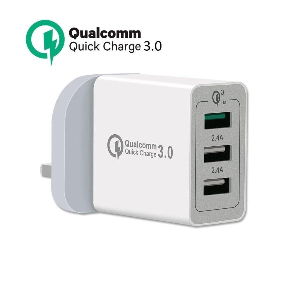

I saw this type of charger selling in Carousell for $12 which suppose to charge smartphone very fast wan. But they say dun hab the "Safety Mark". When I ask them, they say must place deposit, then they will import. Just wondering is it safe to use or not ah, if dun hab Safety mark?

Bought this type b4 on shopee for $7. Gets quite hot during charging and I could smell some burning plastic smell. Threw it away after that and bought a branded one instead.

If you are looking for Qualcomm's quick charge power adapters, please get from more established brands.
I have 2 at home used since 2017 without any issue. Tronsmart and Aukey

This is not standard charging but QC 3.0
It is better to buy one with a known brand instead of this no brand OEM.
If not there may be problems and damage your device.

Type C to C cable usually are quite safe. The ones you need to take extra care are Type A to C, which may result in overcharing if the manufacturers cut cost and do not put in resistor.

I bought a 4 from TB thru 2 sellers. 1 QC port become slow charge, 1 QC working but other 2 ports super slow charging, 1 QC still working, normal port became slower, last 1 rarely use, all working for now. Lucky got if cheap like $7 each. The heat generated with you charge using all port is terrible, probably the reason for failure.
on good side, 3 of them still have QC working. so using them as single port for the past 1yr+

Actually cable matters but you don't need expensive ones. If you really want to know how fast is the charging, you need a USB power meter, like this one. Now they have the USB C output where you can just connect directly to your phone USB C port. App based current measurement is not accurate and doesn't take into account the voltage you are charging at.
If you are looking for charger now, look for one that is PD compatible. More phones are now PD compatible and it seems Google is making manufacturer support it in future. Another thing is that priority always goes to the PD charging for multi port charger.
