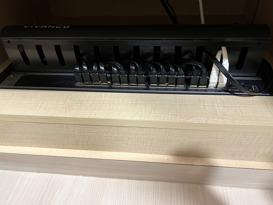

hi may i know where u custom made the short depth rack cage? How is the ventilation if the door is closed?
TanKianW
Apr 21, 2005
6,907
3,616
hi may i know where u custom made the short depth rack cage? How is the ventilation if the door is closed?​
Taobao. Just provide your measurements.
For my case, good enough ventilation. Reason being I made cut out holes on my custom cabinet, together with USB powered fans.
Look something like this:
