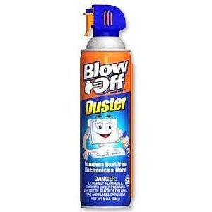

Without removing the HSF . just using the compress air can also can clean it right ? Cause I don't dare remove the HSF . haha . I not very DIY person . every time use 2-3 can should be enough huh .
