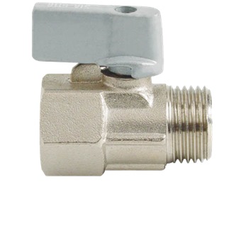

The 2 elbow joints looks like compression fittings. Make sure you have some spare olives to reuse the fitting.
I wont need the elbow joints. I will connecting the steel braided hose inlet to one of the T connector outlet and the I will use a plug to close the other outlet of the T
This is how the new tap and the new hose look:
revhappy
Mar 19, 2012
12,208
2,669
The new tap arrived an hour ago, and I have managed to fix it, successfully so far, no leaks, touch wood :) Even though I closed the main valve, there is flow of water at low pressure, so I didnt get much time to use the white seal tape. There is the rubber washer that does the job of stopping leaks, hopefully this works. The tap quality isnt great. Feels very very light compared to the old one, which was really heavy.
I bought this type of small level handle before as it is cheap (less than $35) and ended up I changed 3 times within 5 to 6 years. Same problem. The water would just flow from the nozzle and no matter how I closed ot. Then I realised why my basin tap mixer at the toilet never leak after 13 years and I went back to the shop this time and I told them and they suggested me to get those mixer tap like my toilet basin. Just hope it will last
