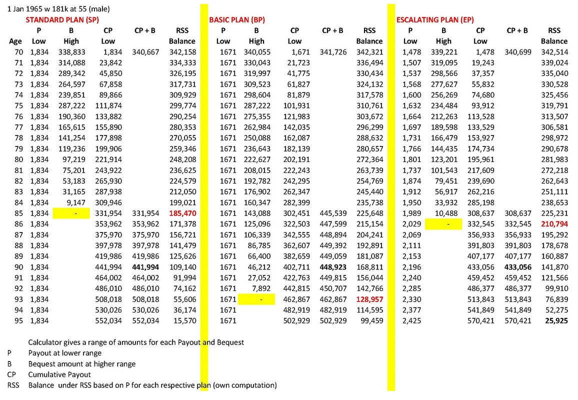

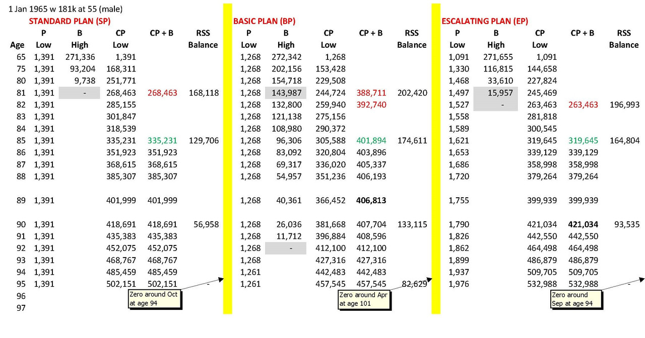

The table shows the payouts under the 3 plans, of a male born 1 Jan 1965 with 181k at age 55.
The payout (P), bequest (B) and cumulative payouts (CP) are taken from CPF Life Payout Estimator.
For payout, I picked the lower payout in the range given and for bequest, I have picked the highest in the range.
The fourth column (CP + B) under each plan is the cumulative payout plus bequest.
The fifth column (RSS balance) is the balance under the old Retirement Sum Sum based on the payout under the respective plans.
Observations –
What matter is the cumulative payouts plus bequest at time of demise? And does delaying payout matter?
BP is the best all the way to about age 90, followed by SP. From age 90, EP is the clear winner. The numbers does not take into account time-value of money and assume no future changes.
Up to about age 94, all plans would lose out to the previous RSS.
Above age 95, SP and EP would better of under CPFL than under RSS, whilst BP would have to be more than age 101 to be better of under CPFL than RSS.
Conclusion –
Up to you to decide when you are likely to uplorry and how much you are to prepared to lose or gain in selecting one of the plans :s13:
Give your observations.
Thanks to uncle henry for the hardwork. Now I put 2 tables together above, who can spot the differences?

bequest is gotten right at the end. early money is worth more than late money. bequest is worth less than since it is given out in front.
xirr takes this into consideration.
bequest is given out at the back. that is why it is no good
there is nothing wrong with everything that you have posted.
your above statement is correct.
it is that you are using cp+b as an evaluation which plan is better. you cannot do this.
I am confused by your above statements on bequest specifically ... in front and at the back.
Whether front or back, the bequest includes interest. So what's wrong?
