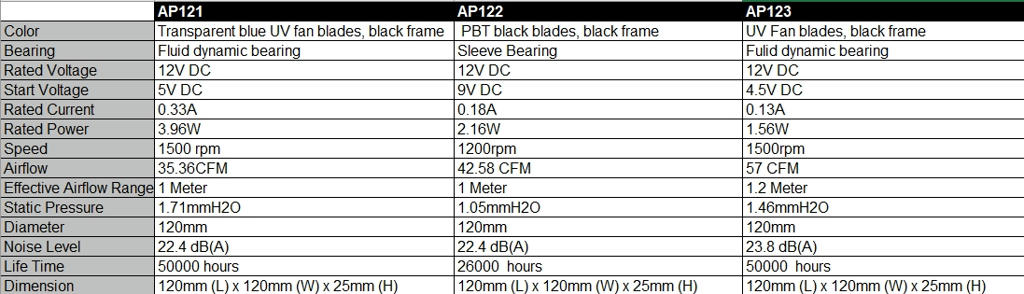

SilverStone – Taking chassis fan to another level
Silverstone SST-AP121
A breakthrough computer fan with air channeling technology
■ Industry leading air channeling fan.
■ Wide fan blades for reducing air resistance.
■ Standard 120mm frame for maximum compatibility with CPU coolers.
■ Integrated air channeling grille double as fan guard to reduce overall size.
■ Low power consumption.
■ Fluid Dynamic Bearing (FDB) for high reliability.
Model No. SST-AP121
Color Transparent blue UV fan blades, black frame
Bearing Fluid dynamic bearing
Connectors 3pin
Rated Voltage 12V DC
Start Voltage 5V DC
Rated Current 0.09A, 0.33A (Max.)
Rated Power 1.08W, 3.96W (Max.)
Speed 1500±10% rpm
Airflow 35.36CFM
Effective Airflow Range 1 Meter
Static Pressure 1.71mmH2O
Air Speed 2.5m/s (measured at fan exit)
Noise Level 22.4 dB(A)
Life Time 50000 hours
Dimension 120mm (L) x 120mm (W) x 25mm (H)
Extra Includes two speed reduction cables
Silverstone SST-AP123
Taking air channeling fan to another level
■ Mixed fan blade design for noise reduction
Model No. SST-AP123
Color Blue UV fan blades, black frame
Connectors 3pin
Start Voltage 4.5V DC
Rated Current 0.13A, 0.33A (Max.)
Rated Power 1.56W, 3.96W (Max.)
Speed 1500±10% rpm
Airflow 57CFM
Effective Airflow Range 1.2 Meter
Static Pressure 1.46mmH2O
Air Speed 2.1m/s
Noise Level 23.8dBA
Life Time 50000Hr
Weight 157g
Available: Fuwell, Cybermind, Pcthemes and VideoPro.

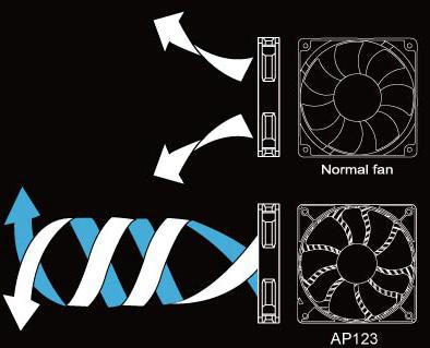

The effect of airflow direction and air channeling inside computer chassis
The “Air Penetrator” series fans dramatically improve airflow efficiency over traditional fans. The combination of fan blades twisting air into the swirl-shaped fan grille forces airflow to tumble forward in a circular fashion that virtually eliminates dead spot. The air penetrator’s airflow is vastly more focused, and can reach much further as well. This design is also superior to adding a honeycomb grille on a traditional fan because there is one less obstacle for air to travel through.

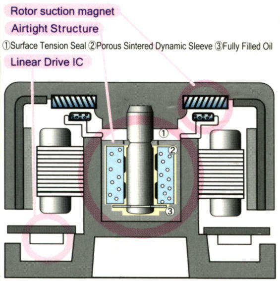

The Truth About Fluid Dynamic Bearing (FDB) Fans
Lifespan & Noise: Fluid-dynamic fan bearings have the greatest lifespan -- ranging anywhere from 100,000 hours on the low end (40-70C) to upwards of 500,000 hours, depending on the fan selected.
These hours are all projections from tests performed in reliability labs, of course, which simulate the stress a fan would receive by using varied test methodologies -- but that's an entirely different article.
Fans using fluid-dynamic setups remain very quiet throughout the entirety of their life. As a quick comparison, two fans that we used in our noise level test rig are spec'd like this:
PHP:
Bearing Spec	        Sleeve	Fluid/Hydro
Operating RPM (Controlled)	1200RPM	1200RPM
Noise Level (Variable)    	~22dBA	~18.7dBA
Operating Temperature (Controlled)	50C	50C
  • Mounting: Fluid fans can be mounted in any direction without hiccup.
  • Performance: Fluid-dynamic bearings are made for high-performance rigs; they are generally preferred for sustainability and relative silence, while pushing the same or more air (measured in CFM) as other fans of their range. These fans tend to run a bit more expensive - a couple bucks on the consumer level - but are worth it for anyone wanting an ultra-quiet system.
  • Additionally: Maglev bearings are another technology that attempts to approach silence in fans, but they are not yet widely used and are not covered here.

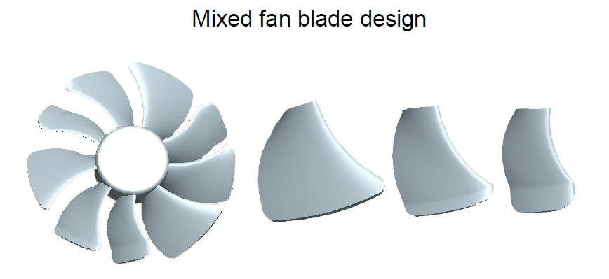

Mixed fan blade design - AP123
The AP123’s most distinctive feature is its mixed fan blade design. Thicker blades have better air pressure performance while thinner blades have better airflow. By mixing three different types of fan blades, the AP123 can achieve more balanced overall performance for air pressure and airflow.
Unique air channeling ability - AP121 & AP123
Unlike most fans that are designed for higher airflow rating on paper, SilverStone’s Air Penetrator fans are designed to channel airflow more effectively. By pushing airflow forward in a circular pattern, it reaches farther and helps to better cool components inside a case.

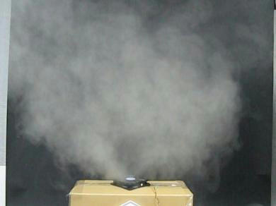

Silverstone Vastly improved airflow focus
AP121 & AP123
Normal Fan
How airflow can be affected by air resistance. With the fans sucking fog out of the test box, you can see clearly the AP series can direct air in a much more focused column.

SilverStone used superior bearing with Fluid Dynamic Bearing for longer life and quieter operation.
AP121 & AP123 uses premium Fluid Dynamic Bearing (FDB) for longer life span than normal fans. FDB also provides exceptional smoothness and quiet operation over its life span.

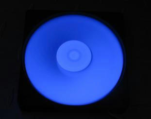

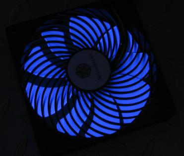

Blue UV effect of AP121 & AP123
AP121’s cool blue UV looks are back with the AP123! The fan blades are UV reactive and produces glow-like effect when in the presence of UV light.
AP121 Glowing
AP123 Glowing
AP121 & AP123 fan blades are made with UV reactive material for the cool blue look when used next to a UV light source.
