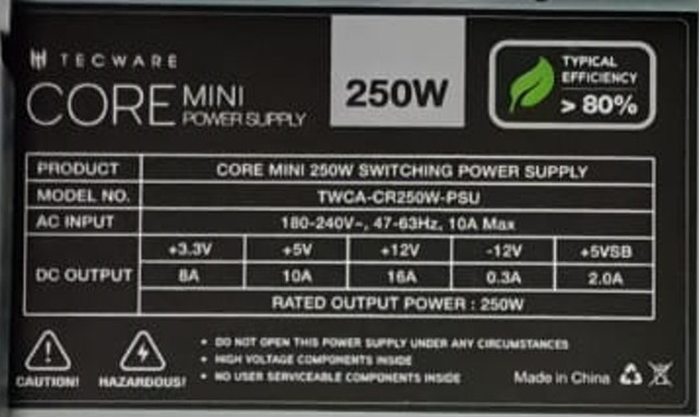

The PSU came with the case. It is a TFX sized block rated at 250W with "typical efficiency" >80% .
