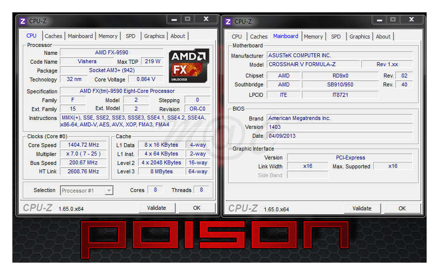

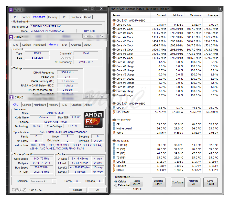

After weeks of waiting, it finally arrived...
CHVZ_CPU-ZCopy_zpsa3b5489a.png~original
MacClipper
33,617
4

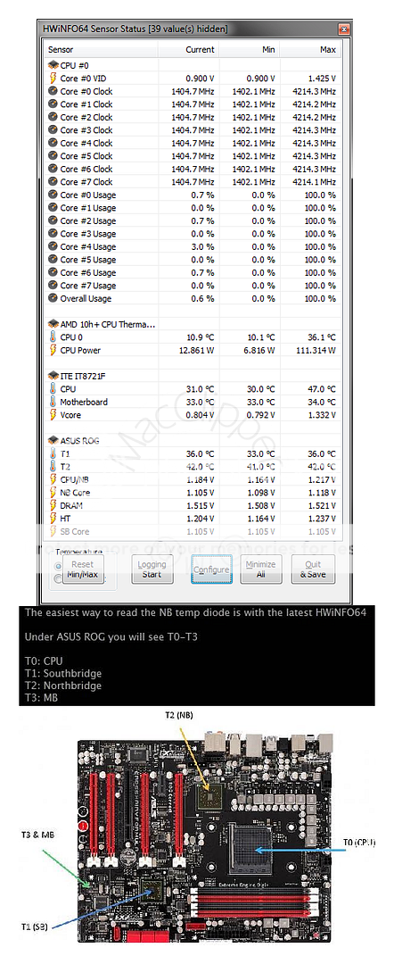

jus curious, does "CPU" circled in blue refer to temp at the motherboard cpu socket? if yes, then shudn't the cpu itself also be in that range too (actually slightly higher)...? eg. maybe abt 70-75C instead of 49.4C.
Dug up again, info specific to the ROG Crosshair series
And this is what it looks like for the FX-9590 after an hour of mainly web surfing and some Cinebench/WinRAR benching.

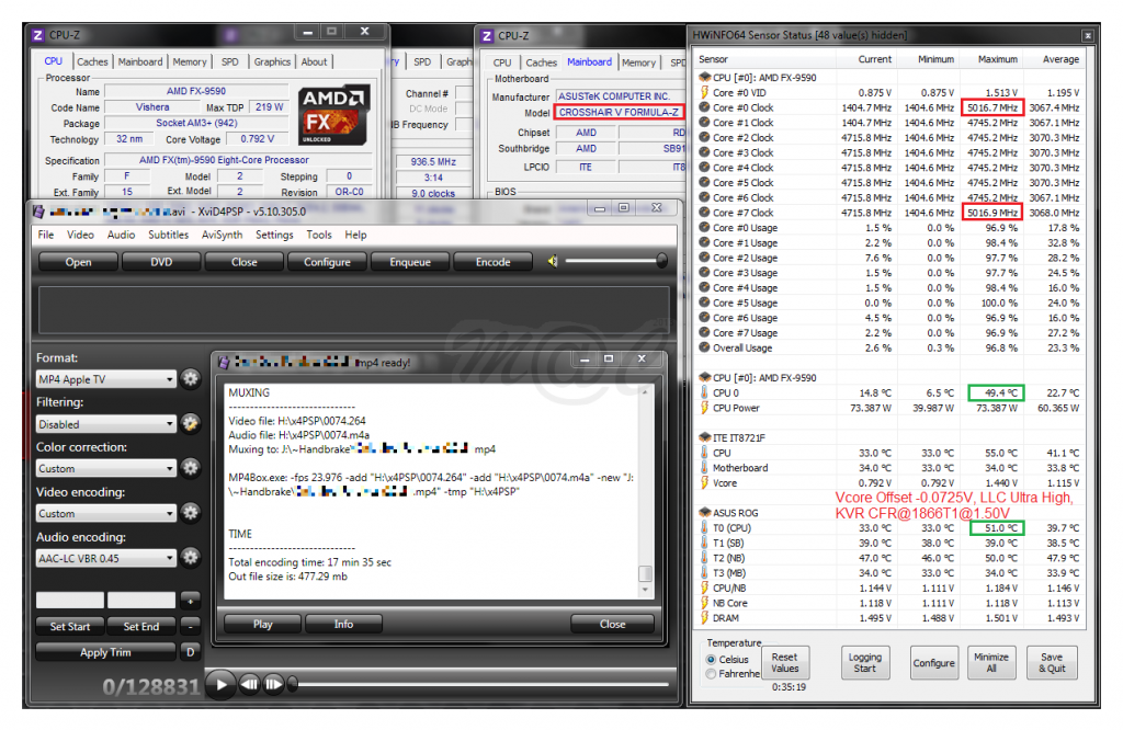

Load Temps
Max load DTS very similar to the Extreme9 and here ROG CPU (T0) temps seem very close to DTS too
CHVFZ_xvid4PSP5GHzTurboUV_OKCopy_zps86053b7c.png~original
hlots123
Apr 5, 2006
5,207
11
thx for the follow-up, mac :)
yah the temp readings with the asus board is easier to make sense of :)
side qn, any ideas why despite the low load temp, how come amd specs for max temps (when stated) are usually much lower than intel's? i thot silicon wafer tech shud be abt same for similar generation whether amd or intel wrt silicon/circuit degradation...
and the working range for the amd cpu package sensor (only valid above 40c?) seems so narrow.

Cannot compare like that cos quite different designs and platforms mah...

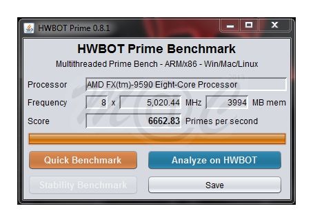

HWBot Prime
Bumped up scores from 6653 to ~6663 with lower latency 1866C8 RAM
Old score
New score
CHVFZ_HWBotPrime5GHz_1866C8_6663Copy_zps42033567.jpg~original
Nice! :)
MacClipper
33,617
4
Running RAM at 2133C9 didn't achieve any higher scores. So yeah, I think that's a pretty decent score improvement.
btw, don't expect any single socketed Intel rig to come close to this score even for the enthusiast LGA2011 platform, much less the mainstream 1150/1155 rigs. :)

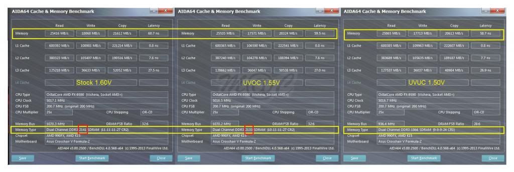

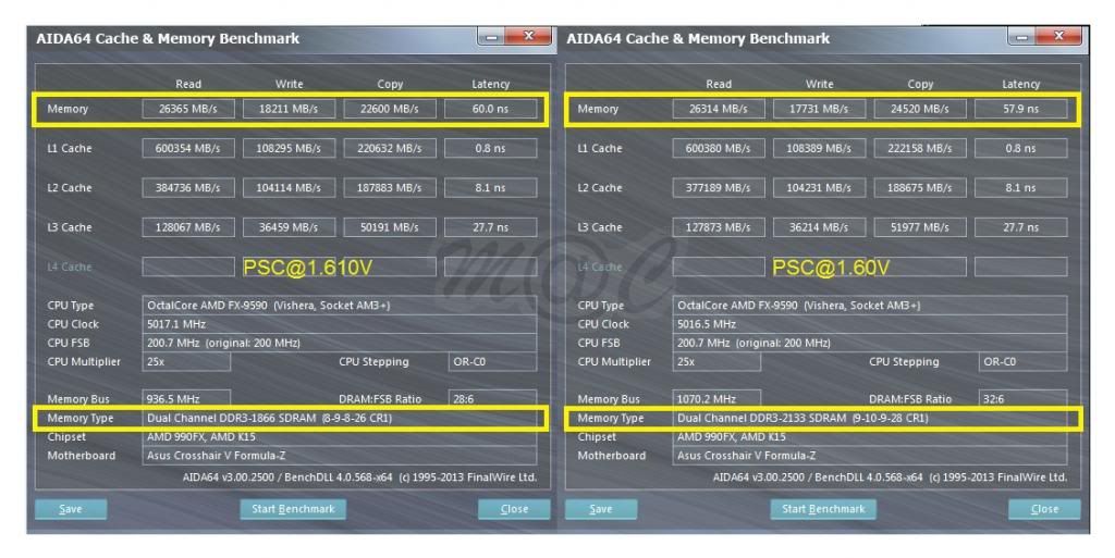

Memory Bandwidth Scaling
FX-9590 on Crosshair V Formula-Z 1304
Corsair Vengeance Pro DDR3-2133, "Intel RAM"
- Samsung SS memory
AIDA64_ComparedVen2133Copy_zpse49ac778.jpg~original
Team Elite DDR3-1600
- PSC DS memory
AIDA64_ComparedPSCCopy_zpsd1687279.jpg~original
