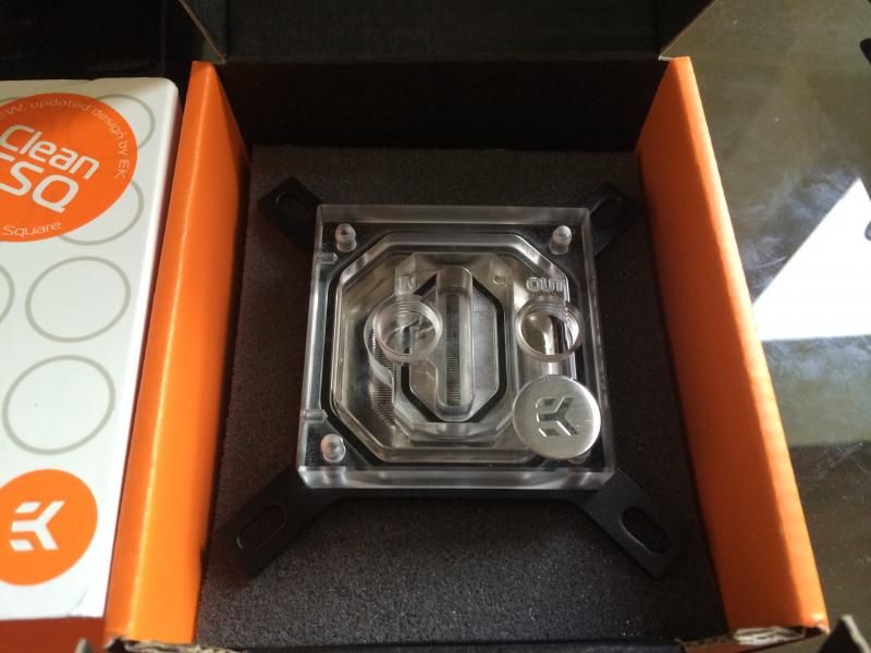

EK Supremacy Clean CSQ
While im waiting for my GPU Block enroute via DHL should reach on Monday Morning or if I am lucky tomorrow evening
I opened up my CPU Waterblock and assembled my pump + res into place
EK Packaging is incredible. The attention to detail and premium packaging really makes a difference
Opening up the inside I am even more surprised with the EK Supremacy looking mighty fine in its nickel plated glory. Looks way better than the XSPC Raystorm or Alphacool block. Makes Swiftech look like a plastic toy in this regard
I opened the block to analyse it and swap out the jetplate one more suitable for LGA 1150 (Haswell) since it came with a generic one. The O rings are extremely tricky to seat so I wasnt sure if it was properly closed so I had to leak test it.
Filled it with some Mayhems Pastel White
Also fitted the pump + res via male to male g 1/4 fittings. This will be hidden behind so I dont care so much for its aesthetics
Luckily no issue even without rotary fittings only thing was that I had to remove the Anti-vibration foam plate and install before reattaching it
Im using cheap barbs here since its hidden behind and cant be seen. Those that can be will all be using Monsoon Free Centre Compression Fittings
