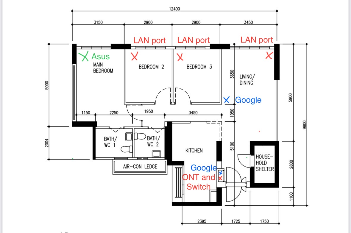

ngyhms
Nov 21, 2009
27
Hi all,
Would like to seek some here on the network equipment setup.
I am living in a 4 room hdb and currently using 2 x Google Wifi and 1 x Asus 3000p. I also have one switch in the DB box. I am using StarHub 1gbps today.
I am upgrading to the StarHub 5gbps. Can I check how should I upgrade my devices to get a better experience and enjoy the upgraded speed.
My flat is a new HDB and has wired connection to all bedrooms and I would need at least 2 access points.
Thanks in advance!

Hi all,
Thanks in advance!
Does you plan come with the ONT plus free HB710?
Please post your floor plan with the location of the FTP, LAN ports location and the current placement location of your two Google WiFi and Asus RT-AX3000P.
ngyhms
Nov 21, 2009
27
Hi Xiaofan
Thank you so much. Yes it is ONT plan with the option to buy HB 710 @ 126. No free HB710 because it’s a recontract but managed to ask for a small discount if I buy the router.
Please see my current setup.
Thanks
xiaofan
Sep 16, 2018
31,039
8,656
Hi Xiaofan
Thanks
I think you can try two HB710 first.
First HB710 at S$126, second HB710 at S$192 (assuming no discount).
Main HB710 with the ONT. Then you can carry experiment to see where to put the second HB710 (eg: Bedroom 2). HB710 only has one 10G WAN port and one 10G LAN port, so the other room LAN ports will not be functional.
If you need the room LAN ports to be functional, then you may want to get EB810v as the main router (S$360) and then use the HB710 as mesh node.
ngyhms
Nov 21, 2009
27
Thank you.
Just to check if I have a switch? Then I can convert from 1 input to 4 output at the DB box right?
