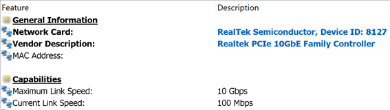

Just got my TX401 v2 and tested it out.
Motherboard: MSI B450 Gaming Pro Carbon AC, installed in a PCIE 2.0 x16 slot.
Driver: Marvell_AQtion_Win_v3.1.10
Cables are at least Cat6
M1 6gbps plan, Archer BE805 router.
Result: 1932mbps down, 661mbps up. (Speedtest.net)
Theoretically the hardware should be able to support the 6gbps plan, I wonder where the problem is.

Can i ask, when say i am using the most bottom PCIe slot, i mean i am using the most bottom full length PCIe slot (although only connect on part of it), its labelled as PCIeX16G4_2 on the mainboard manual. I am not using the short micro PCI. Does it still explain why cannot hit 10GB ? thks for advice
If in doubt, can double confirm with HWiNFO > Bus > ***
For example below look at PCI Express on the right pane:

But I thought PCIE 2.0 4x is enough for 6gbps? Atleast that’s what ChatGPT is telling me.
AQC113C supports the following bus width. So it can only reach 8Gbps max theoretical speed (real world may be 6Gbps to 7Gbps) if you use PCIe 2.0 slot (up to PCIe 2.0 x 2). Your speed is extremely low, which may indicate other Windows issues like 3rd party Antivirus or Security apps. Some users have to reinstall Windows in order to get proper speed with AQC107/AQC113C. You may also check the negotiation speed, which may stuck at 2.5Gbps judging from your test results. Change the Ethernet cable to see if that helps.
